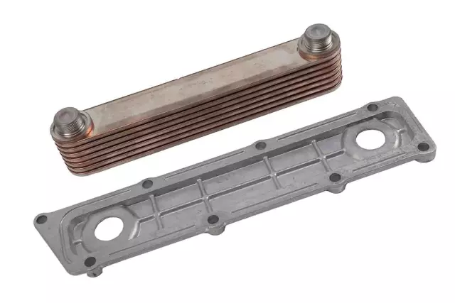

I don't really know about the troubleshooting of this particular case. But I can give you some info about the oil cooler.
I replaced mine (preventive move) by a stainless steel one from ACS (Advanced Cooling System), which is Ukrainian supplier for a lot of Opel/Vauxhall parts.
https://acsparts.biz/en/maslookholodzhuvach-90412391-opel-saab.-nerzhaviiucha-stal/
The part is 113€, costs near 150€ after all customs and taxes.
It comes with both new o-rings. Then you need 4 new bi-material rings and 4 new metal rings for the 4 banjo bolts of the cooler itself and the cooling bridge.
My genuine one is still like new but it's the aluminum one, so I don't want to propose it to you :D it could fail at anytime

Much appreciated. It looks different to what I expect. I thought they were flat (a bit like an air cleaner element). I've not seem one, just photos.
Graham.

The original one is flat
If you look on the 3rd picture on ACS website, the shape is a bit square for the cooler to fit correctly in the block :y
You can take a look at my topic here https://www.omegaowners.com/forum/index.php?topic=151703.msg2058124#msg2058124 but it seems the pictures are gone :-\ ;(
