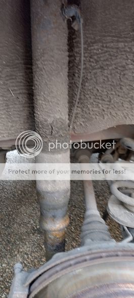

Because you all cast much doubt in my mind over this, I went outside, down to my garage, and jacked up the offside rear of my car, taking the wheel off.  What I found was, I now believe, signs that there is a S/L system, but I don't think it is working due to what I have stated previously.  I have taken photos of the shock and diff which show signs of a S/L system, and I am trying to remember how now we can transfer photos from a current host site onto the OOF so you can judge yourselves and advise please. :D :)

basically if the shocks have a large rubber bellow covering the centre section rather than a simple tube over tube look then they are indeed SL shocks but it cannot see how SL shocks could have a light misting of oil (ie a leak ?)all over them as where would the oil come from unless the rubber is perished or the actual body has a pinhole .

YES!! Managed it finally!!
Sorry for the Photobucket banner!  But can you see enough to advise please?? ??? ???

yep self levelling indeed so if thd vx garage can keep ti their price you will indeed get a bargain but they wont !
so its as suggested ealier
2options
find the correct shocks and make sure the system is working or
convert springs and shocks to normal style (dont know if this would be classed as a modification to the vehicle thou ??
2options
Thanks :y :y
I will now give that problem to my Vx dealer, and hold them to their quote!! >:D >:D

……..and one more point regarding S/L shocks, apart from your estimate of costs DG, is that they are not available. I note even as early as 2019 comments on the web mention that.
So standard shocks it is ::) ::) ;)

putting all the above to one side for the moment
i cannot underdtand how 2 rubber booted shocks can have a light misting of oil anyway ?  i would have thought the only way oil could leak out of those would be a holed body in ehich case they surrly should be a definate fail so i suspect theres nothing actually wtong with your shocks at all ???
