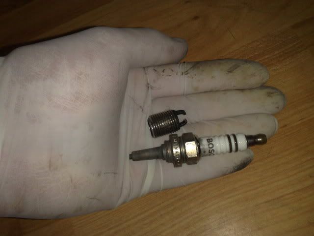

Feeling a tad better today.

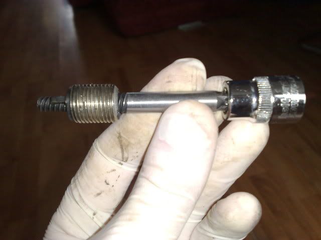

Took a walk to local tool place, bought some easi-outs.
Well, they certainly do what they say on the tin!:
Just need to check / clean out the bore as best as I can now, and pop a new plug in....

« Reply #1 on: 22 June 2009, 12:20:13 »
I find them shite.....really shite and wont use them.

Could that be why I had a problem?
Interestingly Mark - I thought (no idea why) that Bosch made them for GM - and only bought Bosch because it was Sunday, and I needed plugs...  :-[

hmmm, was Mark refering to the plugs, or the easyout?

I thought he was referring to the easy-out, but looked like in this case, it appeared to have done the business  :-/
Thats what I thought too, he has mentioned in the past not to like them
can't remember why.
To me any tool in the arsnal to help things like this is worth having.

Looks like a faulty plug.
Bosch is complet and utter german crap, I have not had any good expiriences with Bosch and thats with all there products.

Mark - if you meant it's the easy out that's shite - what would you use in it's place (short of removing the head?)
Always keen to learn about useful tools!
I am just grateful that in this situation, it did it's job, and got me outta potentially big trouble!
The bore had no bits in - I popped another plug in there (threads are fine) and it runs on all cylinders now  8-)

I would write to Bosch and ask them for a replacement set of plugs, but if they're that crap I won't bother, and they'll probably only accuse me of overtightening it anyhow....
Thought you had fitted vx plugs James when you got the car home in your new car thread, i would take the buggers back where ever you got them from tbh
