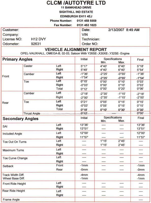

Can you post the figures off your print out.

HI2DVY
QuoteCan you post the figures off your print out.
Here's the main bit...
