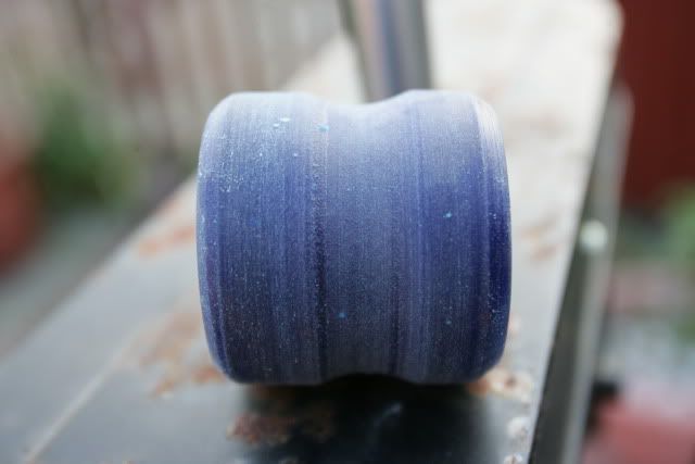

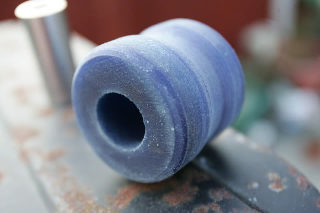

made these up a while back & they work very well
Hmm would give me somthing to do with my metal lathe that hasn't been used for anything important yet...   ::)
