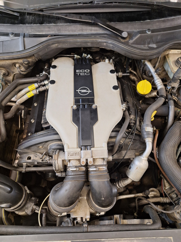

Completed finally my camcover change, no leakages anymore but terrible smell around the car. Had to add about two litres oil before first start as there was nothing to be seen in the dipstick. I think most of the lost oil is burning around exhaust manifolds.

Are the half moon seals correctly seated at the back of each head?
If not they can allow oil to literally pour onto the gearbox and exhaust.

Yes they are, thanks for comment, engine and garage floor absolutely dry. Hope smell dissappear step by step.
