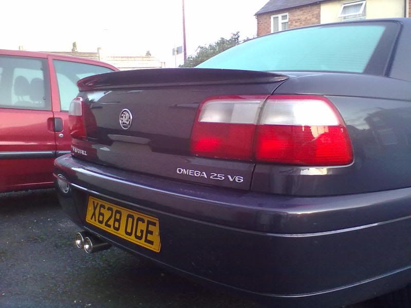

Very pleased. Bit of a pain to fit but paint job is excellent considering its a difficult colour to match.
Camera phone so not best quality ;)

looking good  :y

dan282: what rear exhaust is fitted to your car? looks good :y

Its from powerflow. Standard 2.5" Twin Exit. Have a look on their website as they list all the Tailpipes.

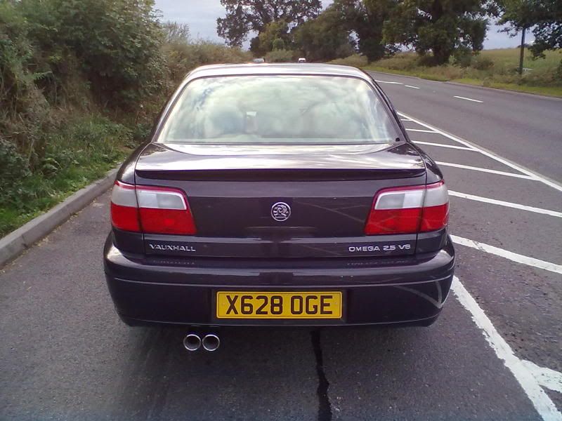

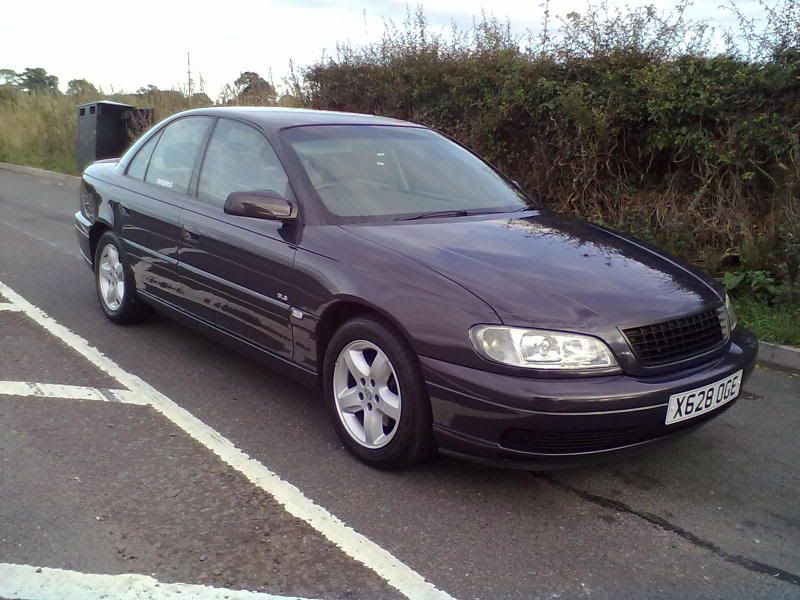

Was taken in December a few months after i had it. No changes.
Before Changes

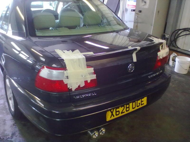

Looks great Dan .... any tips on getting it  to sit in the correct position while you are trying to fit it  :-?

Well before i put any adhesive on i lined it up and marked with some fine chalk where it needed to go. I then with the help of the guy who painted it lined it up after applying very strong bodyshop double sided tape and some adhesive he gave me, Held it down to make sure it was flush with boot for approx 5 minutes and then applied plenty of Masking tape to keep it pressed down. Left overnight and when i took the tape off it was solid as a rock.

:y cheers  .... must get mine fitted now. Just dont tell someone its still sat in my shed  ;) ::)

Looking good, see you changed the number plates & exhaust. The spoiler makes it look a Million Dollars.  :y
