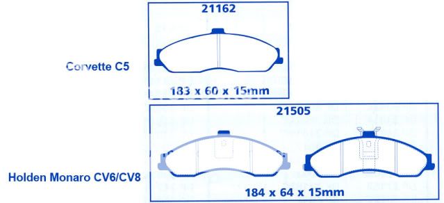

Yes they will, Monaro is same as GTO... but the C5 is has a bigger pad!
Vega
  • The Netherlands
  • Posts: 159
    • Omega Saloon 3.2
Re: V8 Big Brake UPGRADE 220$
« Reply #16 on: 21 March 2010, 19:46:57 »
Not quite right, the Corvette C5 and the Holden Monaro have the same size, the only difference is that the Holden Monaro pads comes with retension spring attach.
Holden Monaro brake pads DP31505C
