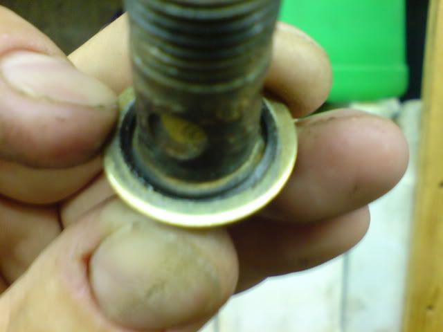

Some furtehr update, not to much done tonight but, the coolant system is all re-fitted and re-filled with new dowty washers (of the correct type) on the coolant bridge. A pressure test revealed pressure held for 60 mins ok and no leaks......

Thermostat and bridge piece look fine, as does the coolant pipe to block seal and coolant plate.
Heres a pic of the route cause of the problem.
Note that its MUCH to large....and the mating lands on the head and coolant bridge are not huge.

« Reply #20 on: 02 August 2007, 08:28:12 »
Doesn't look a very good fit, have you an 'after' pic as well?

« Reply #21 on: 02 August 2007, 08:45:51 »
I will try to get one when my replacements arrive (I keep these washers in stock!) but, the rubber seal section on the correct ones is much bigger and touches the shaft of the drilled bolt, the outer metal section is also smaller.
