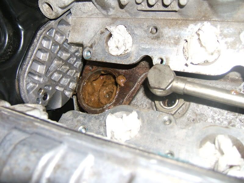

Lots of cleaning today - if it doesnt go when im done at least its pretty  :y Loads of scouring of surfaces and lots of carb cleaner used too.
Seriously though - rad hoses all removed, coolant tank etc as well.
Just finished removal of the thermostat waterway, housing and thermostat as well.
Masses of gunk on thermostat and underneath where it sits :-/ kind of concerns me a bit.
Are we still on for oil cooler failure...?
Or as ive always thought, small chance of hgf?
It seems somewhere in the whole cause and effect scenario something has blown bottom radiator hose off - jubilee clip and all and thrown thick dirty wads of mayo everywhere.

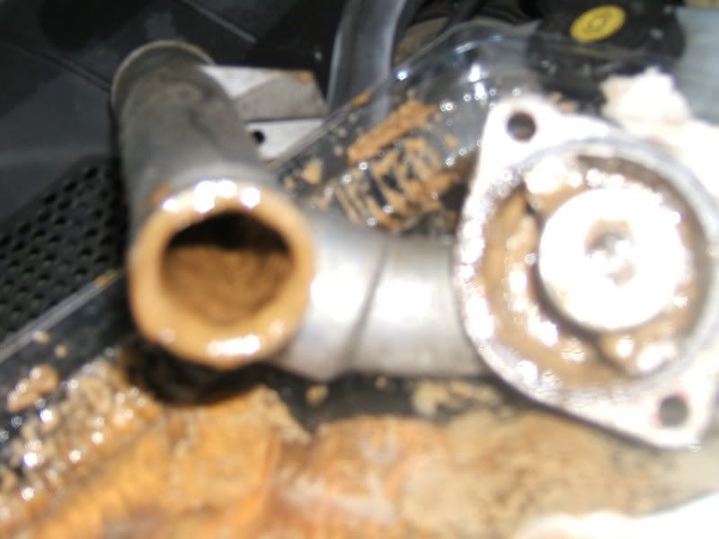

And when i say mayo i mean Really Mayo`d - view where the removed 'stat should be
And `scuse the strange focus on this pic of the 'stat and housing
« Last Edit: 21 January 2007, 18:10:24 by Markiec »
  • Posts: 108389
Re: This Darm Oil Cooler and its lack of access
« Reply #10 on: 21 January 2007, 18:11:37 »
Yup, looks like oil cooler - I take it that it was driven around a bit with the failed cooler...
