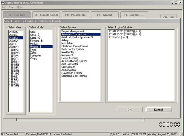

Opel Autoscanner - shows 2003 2.2 gearbox in the menu.
Hav'nt tried connecting though.
Works on my 99 2.5
« Last Edit: 20 August 2007, 16:21:09 by iggy21uk »
Works on my 99 2.5
I need a play with one of these....
Re: ProSan Diagnostic software
« Reply #8 on: 20 August 2007, 22:22:14 »
That scan piccie looks odd ... mine is definately a Dec 1999 V plate ... that shows V plates as 97 !!! something wrong methinks ...  :(
  • Posts: 107657
« Reply #9 on: 20 August 2007, 22:39:28 »
Thats the VIN year and completely unrelated to reg...
