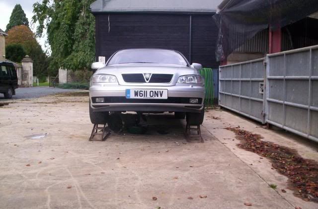

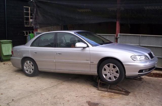

1) Car raised up on ramps:

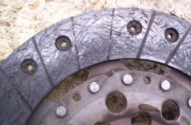

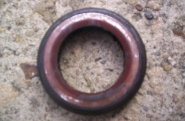

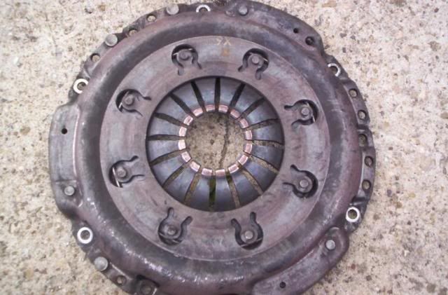

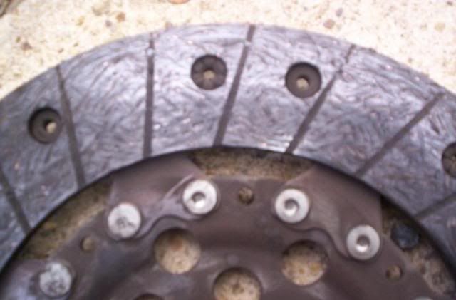

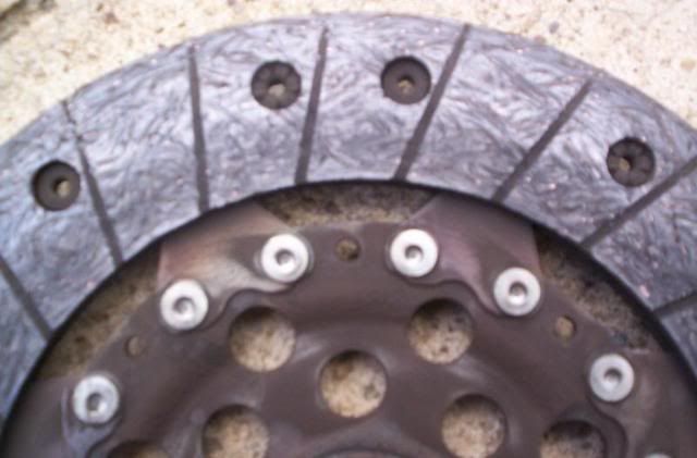

Now I removed the clutch kit. Observations were, that the old friction plate was quite worn and felt brittle. Pressure plate didn't look great, and the release bearing was donald ducked (lots of play) :

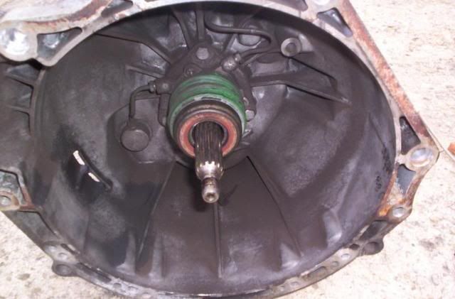

Here is a pic of the release bearing and slave cylinder inside the bellhousing (note the contamination, more on that later)

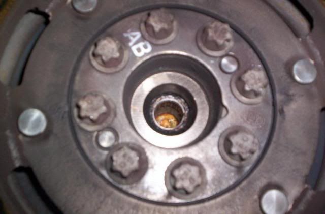

Here is a pic of the dual mass flywheel, didn't look great, but I've now cleaned it up so much I would eat off it!
Note - all the contamination around the lip of the flywheel. There was some in the bellhousing too. It is a combination of friction material, and what looked like a rubber bung, that had found it's way into the box and chewed up in the clutch!!
And here is the spigot bearing, in the crankshaft. This bearing felt fine to turn with my finger:

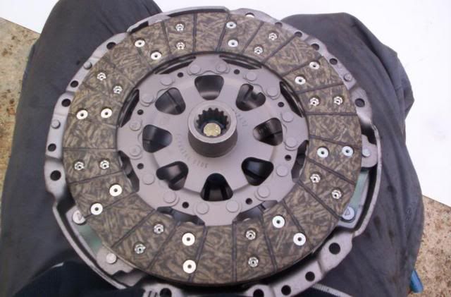

Here are some pics of the new clutch kit which is now fitted - note I'm using a clutch alignment tool, to align the friction plate EXACTLY where it needs to be on the pressure plate:

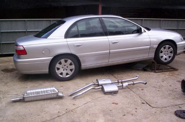

Here is my nice shiny new genuine GM exhaust system, cats backwards.
I noticed that the old exhaust was FULL of bits, and quite blocked. Hopefully this was accounting for the poor performance, and quite likely why it failed.
This new system is now fitted to the car:

Well done James, be careful under the car mate, those ramps dont look to clever.
 :y :y :y
They don't look very wide! How did you get your ramps that way round?   ;)  ;)

« Reply #9 on: 19 October 2007, 20:28:29 »
more to the point :y
 when using ramps for supporting the car in that fashion, i always have one facing the other way so even if you push the car forwards or backwards it cant roll off the ramps !!
doing it this way means you can then jack the entire rear end of the car up and the car remains stable on the ramps
jm2pw :y

All good tips, although bear in mind that at all times I was under it, I had additional support, and wheel chocks at the rear....
