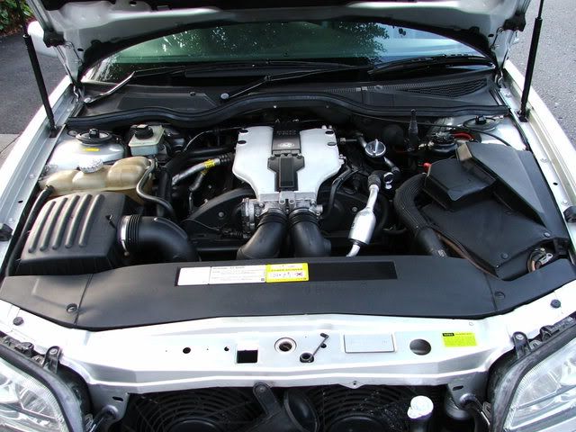

« Reply #8 on: 27 June 2008, 06:55:07 »
Heres a pic, see the green sticker on the bottom right hand corner, this only advises that flouro dye has been added :y
