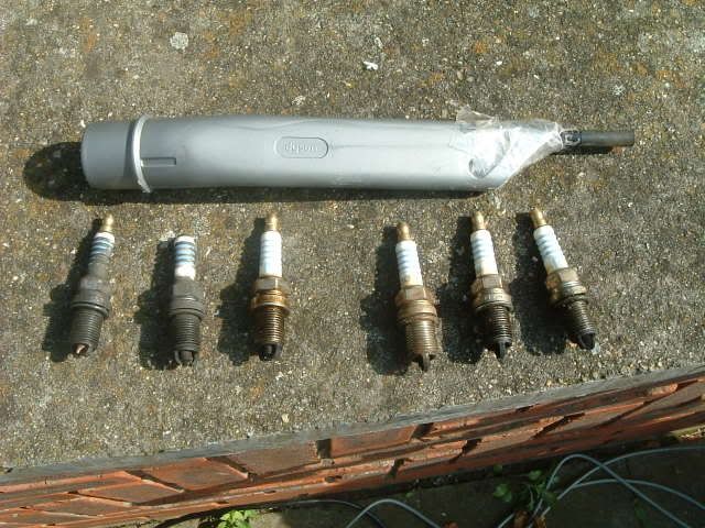

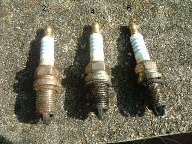

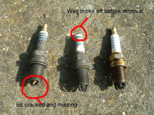

Update.....changed the plugs today, and all appears fine now, see pics below of plugs removed, plugs from 1,3,5 2 of which were naffed and also loose prior to removal as was one plug on bank 2-4-6, anyway seems fine now, cleaned out all the crud from the plug wells etc., and you see my special tool to help remove some of the crud...so all going well back on the road again :y
Oh and these plugs were seemingly changed by Vx at 87k ::) acording to my invoice that I kept, the car has now done almost 115k so did'nt even get 40k out of them ::)

Could just be my old eyes ::) ::) But 2 or 3 of the plugs look like they are twin core instead  of 4 quad core...
Glad its all better now  :y
