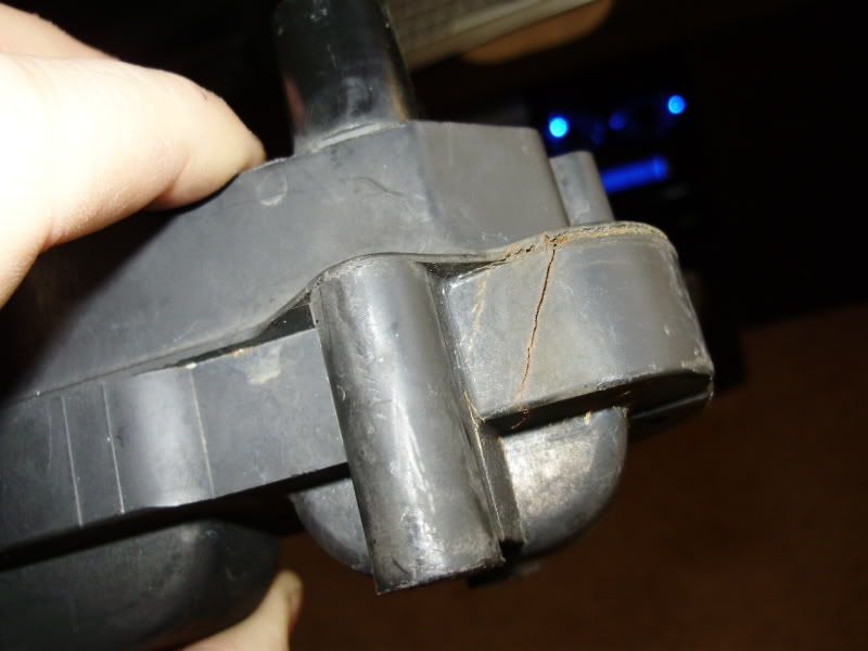

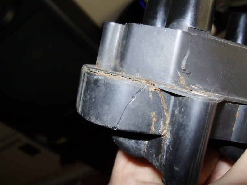

Coil pack now off n found this. It goes from one side right over to the other  :o
What could of caused this??
Number 1 is right next to this and thats the one thats not firing.
Wonder why?  ;D ;D
Anyone for a bit of rust??  ::)
« Last Edit: 12 November 2008, 15:32:25 by bighed »
markey mark
  • SLady bitshorpe north lincs
  • Posts: 4236
Re: Help please
« Reply #27 on: 12 November 2008, 15:32:46 »
water ingress bud ! :( usally caused by faulty hbv  ::)
bighed
  • Shropshire
  • Posts: 883
Re: Help please
« Reply #28 on: 12 November 2008, 15:38:06 »
really? Wheres that then??
« Last Edit: 12 November 2008, 15:40:40 by bighed »
markey mark
  • Posts: 4236
Re: Help please
« Reply #29 on: 12 November 2008, 15:39:11 »
back of engine opposite side to coil pack  :y
