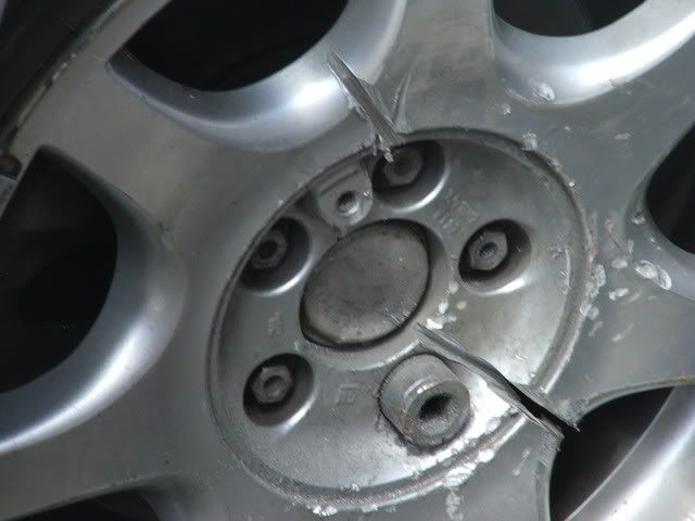

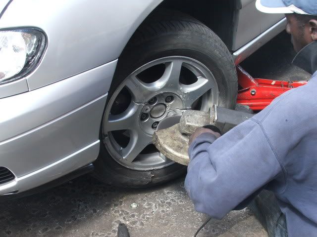

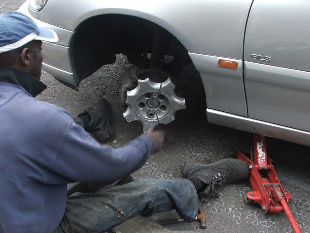

Another bloke local to me had the same problem and here's the outcome............

« Reply #9 on: 29 June 2009, 19:33:52 »
now thats what I call drastic. Dont take it to him!!!!

« Reply #10 on: 29 June 2009, 22:02:57 »
No safety goggles... :o

« Reply #11 on: 29 June 2009, 22:09:24 »
Looks way, way to drastic to me...............

« Reply #12 on: 29 June 2009, 22:12:36 »
Does he change spark plugs with the same method  :o

« Reply #13 on: 29 June 2009, 22:45:42 »
what melon did that to a wheel? Can you not just buy a new key? If you dont have the key number is it not on car pass etc? Failing that if the key is original with the factory fit security bolts dont vx keep a record of the key number?

« Reply #14 on: 29 June 2009, 22:52:18 »
Woah thats drastic  :o - I'm not doing that! My alloys are fairly tidy.
