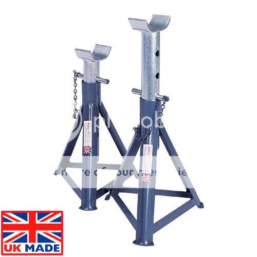

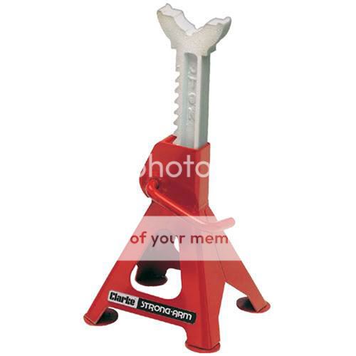

Okay, I'm convinced I need the 3 ton Jack
Now for Axle Stands, Which should I go for?
These?
or these.
I must admit I think the traditional type would give me more confidence. But what is your experience? :-/

« Reply #24 on: 19 July 2009, 17:52:41 »
Ive the Halfords 3 tonne ractchet ones, been very happy  :y
Re: What Trolley Jack
« Reply #25 on: 19 July 2009, 20:12:29 »
And me, far easier to use than the pin ones which are more fidely, just place the ratchet stand under the car and lift the sadle, the ratchet wil catch and let go of the sadle, one hand job.
 Pin ones are 2 hand job which means you have to get both arms under the car and hence head and shoulders also to get the pin in while the car is only supported by the jack. Also and the chain brakes and the pin gets lost.
Ratchet ones seem to be lower than pin ones i think. Or is it because i have a better jack now. The lower the stands first setting means less jacking needed, handy if you have a smaller jack.
Ratchet stands all day long for me.

« Reply #26 on: 20 July 2009, 10:46:25 »
A 2 ton jack is more than enough. After all, at what point can a trolley jack pick up the entire car? It's not going to happen. At worst you are picking up the front of the car, still no were near 2 tons.
And I recently got a set of the ratchet clarke axel stands. The only problem I might face with them is getting the car to the higher clicks on a 2-ton jack. Now I wish I'd bought the 3ton jack!
I know I can jack up, axel stand, block of wood of jack and keep going like that, but tools are supposed to make life easier!
