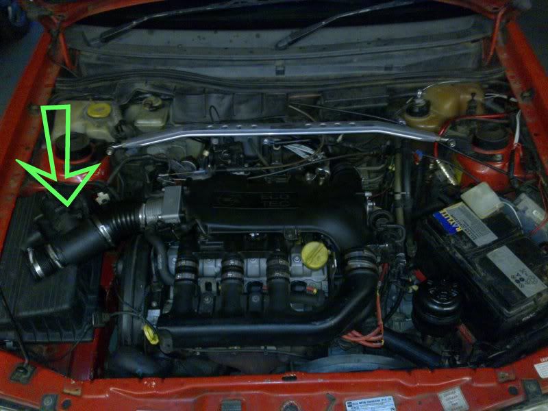

Heres a pic I marked the location of the MAF sensor .
Note that this is on a Vectra B intake but it should give you an idea of what to look for  :y
Thanks for that but its different on the Omega  :(
