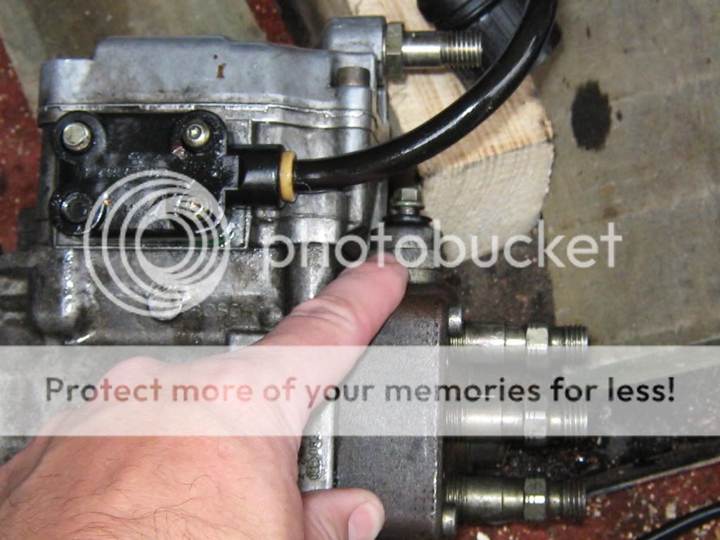

The fuel stop solenoid is at the back of the pump it has a single wire attached and is held on by a 8 or 10mm nut.
If you take the wire off first you should see a dome shapped bit this unscrews I think its a 24mm socket you need.
this is the solenoid ive got a spare if you need it :y
I'll try and post some photos later tonight :y
ignore 92 if you don't have cruise.
if you want cruise just replace the stalk and away you go.
Before you go taking things appart just check the small wire going to the solenoid it might be broken

heres a photo of the solenoid

I have change the fuel cutoff solenoid and the car runs now perfect.
