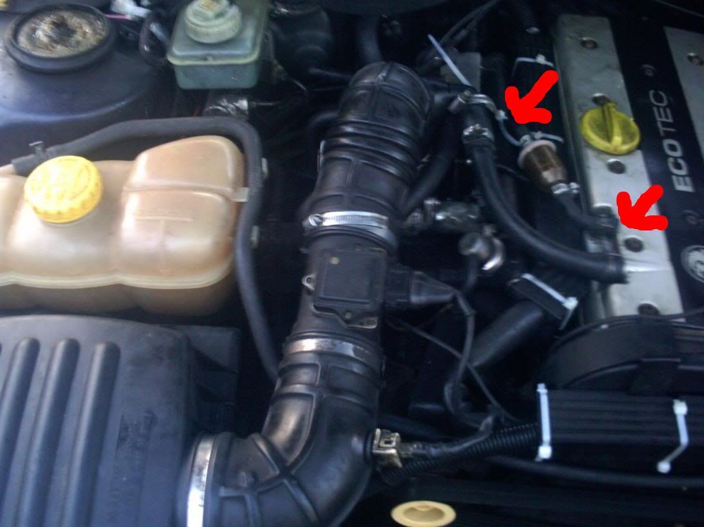

And yes.   small breather tube and hose was first port of call to clean out.  It was acutaly fairly clear, the larger (front) pipe on the head is a little cocked, but all cleaned now with carb cleaner.

Too high. Are you sure there`s no vac leaks. When you did the ICV and breathers did you use a new gasket for the throttle body, did you clean the small hole in the body, did you check all breather hoses were free of splits. Have you checked the large air inlet hose to throttle body for splits
