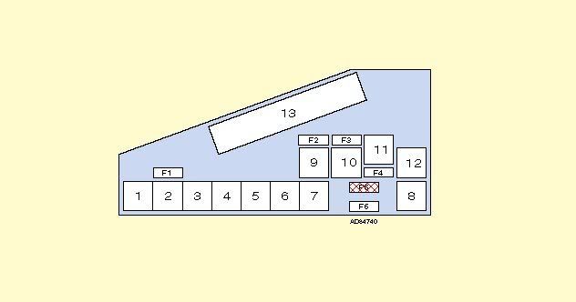

ditto cem....
Mine was whirring every time I started the engine.  Sounded like a plane.  I just disconnected the fuse.  (altho number 29b on mine I believe as I have AC.  might be 29a, just double check ;) )
hope that helps mate :)

Three options, pull fuse, unplug unit or remove totally :)
