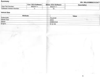

ok ive had the codes read today
error codes found were -
p0340 - cam sensor
p1700 - service request via can
gearbox codes were -
p1792 - can recieves error
p0727 - can recieves error
p0730 - unknown code
they advised me to get firmware updated and i must say its altered the car so much , drives so much better , feels like a different car . only problem is gearbox is still playing up
this time it came up with car/spanner light and went into limp mod , error now is (if i remember correctly) gearbox over rev error - 900rmp to great ( i think its p0730)
i think this is just were 3rd gear is not changing and so is reving to much in that gear instead of changing gear but i really dont know
the garage tried to sell me a recon gearbox for almost £1200 lol , well that isnt going to happen
