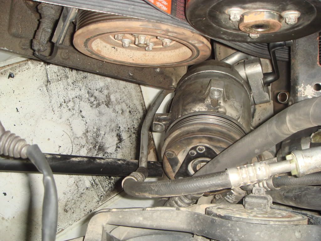

grijander
  • Posts: 46
Re: ac compressor replacement
« Reply #9 on: 09 July 2011, 17:27:05 »
Ecco.....
vbelen4
  • Posts: 31
« Reply #10 on: 12 July 2011, 06:24:21 »
Great pic really. As I see it isn't necesary to free the pipes from its connections upside...

« Reply #11 on: 13 January 2012, 12:36:24 »
also need to replace AC compressor. Repair and reseal costs 250$  :-X
where on Ebay to find good one and cheap? (I doubt the Chinese is OK)
and wath to do with oil dirty sensor (left on the picture)? leave it or repair?
