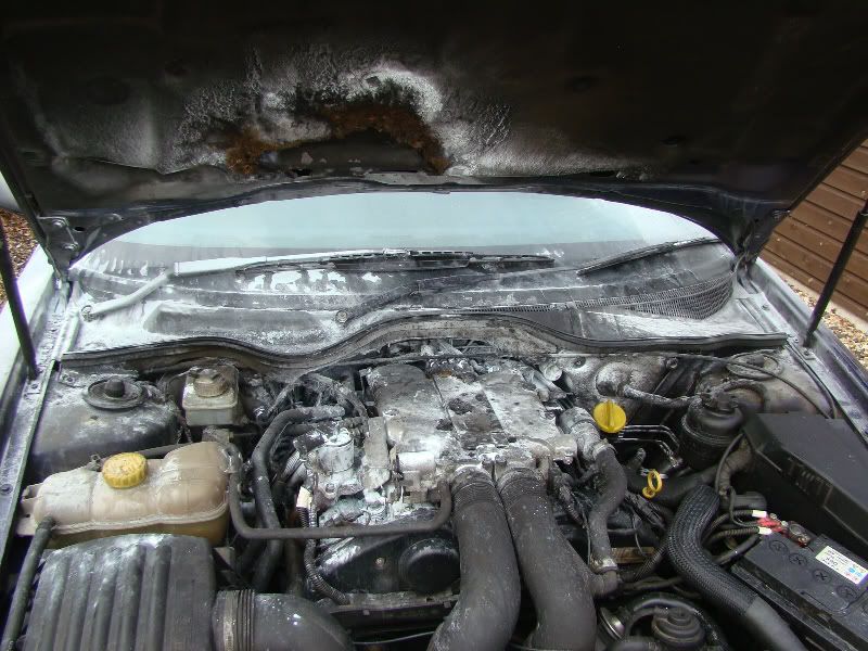

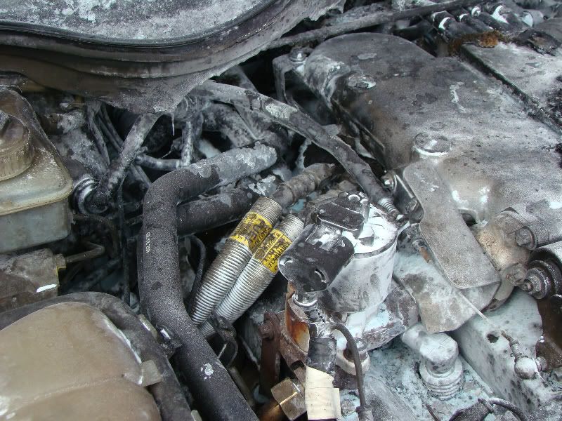

I never did discover exactly what the cause was. It seemed to have started near the fuel pipes where they join the manifiold. I'm going to try attaching a couple of photos (using photobucket) so you may be able to spot something I missed. Fingers crossed as I don't do this very often and will probably get it wrong!
 <a href="http://s46.photobucket.com/albums/f141/hollis583/?action=view&amp;current=Omegafire1.jpg" target="_blank"><img src="http://i46.photobucket.com/albums/f141/hollis583/Omegafire1.jpg" border="0" alt="Photobucket"></a>[img]

Doesn't look like a powersounder fire to me... I'd expect the scuttle to melt quickly :-/ :-/
agreed, not sure what that ones caused by  :-/

Tough one to guess... I wonder if there had been any work done recently before the fire?
If I had to speculate I'd be looking as a slight leak from one of the fuel lines onto the manifold :-/
