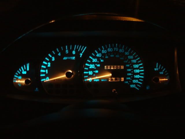

I'm thinking of fitting led dash lights. Can anyone tell me does the dash light dimmer still work and do the needles have there own bulbs fancy blue numbers with red neeles same as the vw's

The three large yellow bulbs across the centre illuminate the speedo and needles. I also have a set of Blue LEDS around somewhere. Heres the link for the custom dials;
http://www.white-face-gauges.com/html/opel_vauxhal_vauxhall_white_fa.html
custom dials from germany, they come in varying colour options, around 68 euros, saves changing to LEDS.

The dimmer does still work, but I found that with the blue or red LEDs the MID was hard to see in the day and the switches were blinding at night.

Additionally, as the dash wasn't designed for LEDs, it won't be overly successful, due to narrow angle of LEDs

I found the MID hard to see in daylight after fitting blue LEDs,Every thing else was OK, so I went to a craft shop and bought some blue glass paint and dipped the original bulbs, Worked fine,also did the heater controls and airvents.LOOKS GREAT! :y
