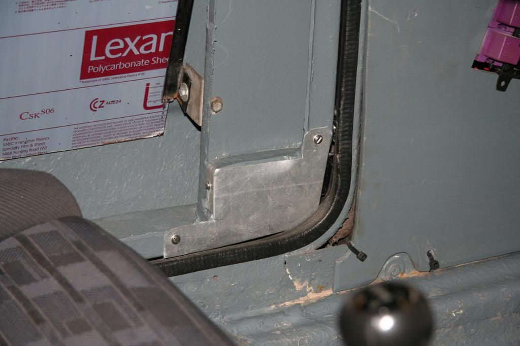

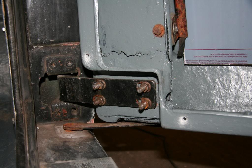

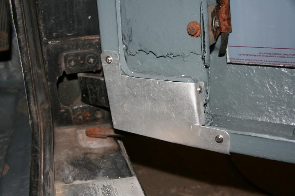

In the mean time, I made up some draft stoppers.  I mae a list before I took the car off the raod of all the niggle little things that needed sorting as well as the new engine etc.  and there used to be a bit draft from the lower hinge area on the doors so I made these:
More to come
