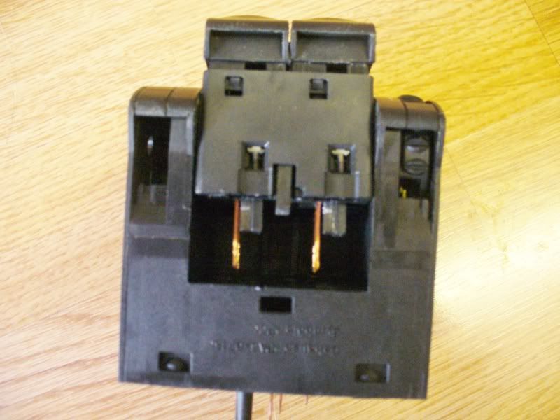

Prise the fog switch bank out from underneath the main switch

Rob, you're a legend!
So am I right in thinking that the main body of the unit is the same for all models (I've noticed they all have the same connections on the rear of the unit), and the fog switches and thumb wheels can be added to any of them?
Also, more for Dan's benefit really, I'm assuming the fog switch part can be removed without having to remove the whole switch unit from the dash?

Main bodies are the same. If you don`t want to snap the retaining tang (2nd pic, middle of contacts) switch needs to be removed :)
