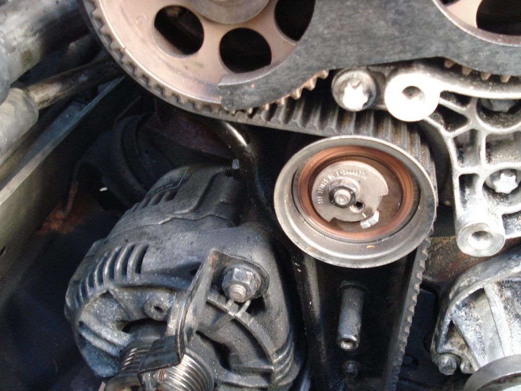

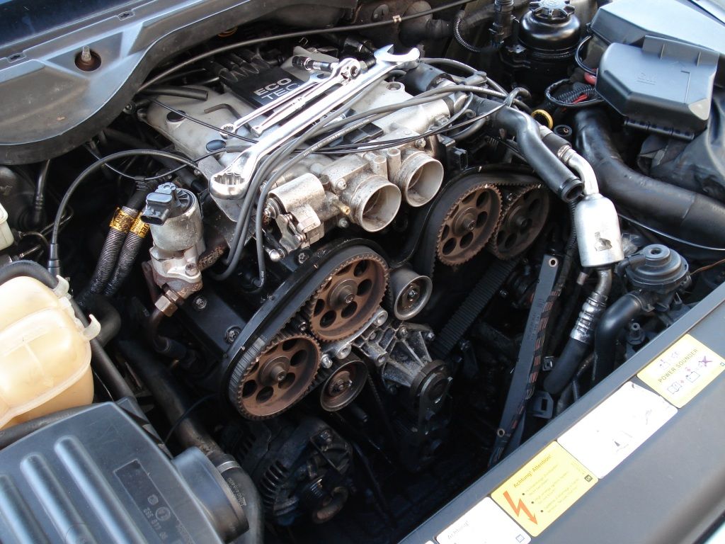

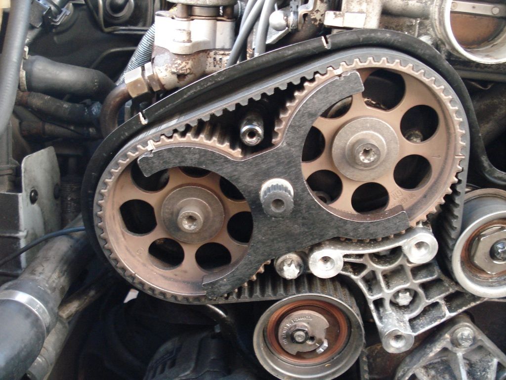

PICS :)
Here's Ralf all timed up correctly..... water pump and all other things to follow when my phone decides it wants to send e mails again  ::)
Tensioner bang on the line as it's a re-used belt:

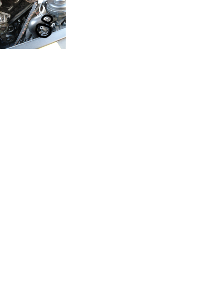

Finally, just looking around at bits and bobs.... does this thin tube go in that small pipe.....??

Is it just me / the picture / the angle - or does cam one look a little too advanced, given the crank is at TDC?

Ps - that last photo looks v small, but the thing you've circled at the front is where the vaccum goes for your SAI :y
PPS - wtf's going on with the HT leads from the 1-3-5 bank, running under the EGR and over the top of the plenum like that? Don't recall it being like that when I took Ralfs plenum off and fixed the coolant bridge leak, prior to your ownership..  :-\
loll no its just the angle of the photo ;) i assure you theyre spot om the markson the tool ;)
as for the leads the disspc is out so all  leads are out too... ill put it all back together soon ;)
