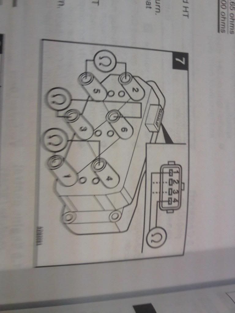

ANYHOW.... Whipped out the disspac today in my free period. I was stupid really cos if I didnt do it in time I'd have been there still now  ;D but luckily it was a lot easier than it was the first time I did it. Anyway he disspac looked ok. It had no corrosion on it and I had a multimeter on it. Firstly looked up the correct resistance tests in the ignition bible we have......
So it tested as follows:
Secondary: (ON THEOHMS 20K SCALE)
2&5 - 11530........... GOOD
3&6 - 11590........... GOOD
1&4 - 11550........... GOOD
Primary: (ON THE OHMS 200 SCALE)
Pin 1&4 - 0.60........... GOOD
Pin 2&4 - 1.1............. BAD
Pin 3&4 - 1.1............. BAD
So......
Do we reckon the primary resistance is really bad or in the real world should it still function and be ok? And this is what is potentially causing the issue.
