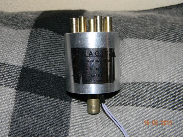

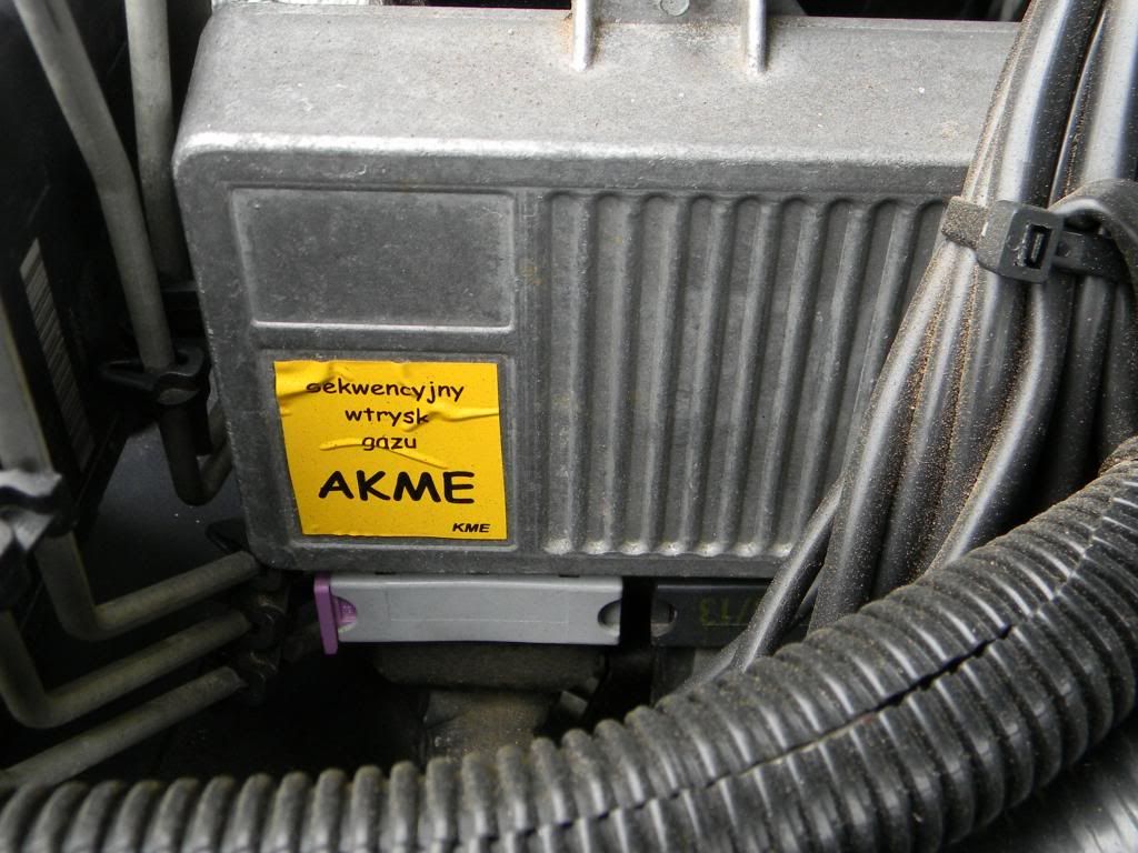

Ok i have changed the magic filter after the vapouriser and found a gas leak on the small bore pipe from the filter that goes up to what looks like a small square box with an electrical plug. i fixed that by trimming back the pipe and fitting a new clip.
I have driven from feltham to mitcham a distance of about 20 miles and it performed fine with no hint of misfire or poor performance, when the new filter arrives from belguim i will change the one i cleaned with carb cleaner.
But i have noticed that the switch over from gas can be a little slow and requires a rev of the engine above 2,500 rpm to make it switch, even when cold or hot, is this a map issue if so that might be cured with a remap of the ecu.(Hopfully)

Re: Jeep lpg help needed
« Reply #19 on: 17 March 2013, 23:26:01 »
Sounds like a setting issue..  Used to do it on the old single point set ups... Switch over only above 2k RPM and even then it only switched when on over run :y

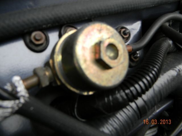

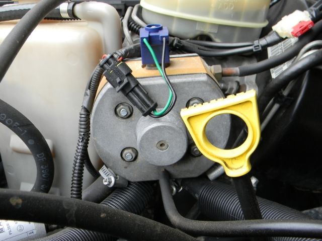

I have done some research on the KME gold vap and it seems there is a temp sensor in the vap, but i cannot seam to find its location, it  has 2 wires to it but mine does not seem to have it, but i cannot see underneath the body of the vap. it might be there so will dig out a mirror and take a gander.

« Reply #21 on: 18 March 2013, 00:02:40 »
It's smack bang in between the vaporiser pipes.
« Reply #22 on: 18 March 2013, 08:38:58 »
Depends where the fitter put it ;) But that's the obvious place and most likely :y
« Reply #23 on: 18 March 2013, 12:05:09 »
em it's actually part of the Vap. on mine. Not moveable unless you want to start drilling holes. Or am i talking about the wrong part
« Reply #24 on: 18 March 2013, 18:13:29 »
It screws in ;)
« Reply #25 on: 18 March 2013, 20:00:25 »
So where else can it be fitted? I'm confused?

« Reply #26 on: 18 March 2013, 22:45:15 »
So am i cos i cant find it on mine ::)

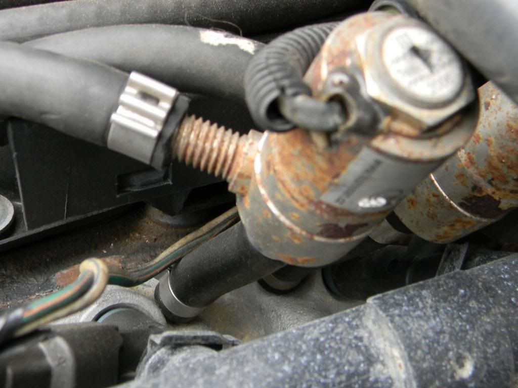

« Reply #27 on: 18 March 2013, 22:48:56 »
In any of the threaded holes by removing the bolt/set screw that is currently in it, exactly as will have been done to fit that one ;)
Look for a 2 wire sensor either in the vaporiser or the coolant lines :y
« Reply #28 on: 18 March 2013, 23:01:37 »
Which leaves me even more confused asI have temp sensor in the VAP and also in one of the VAP lines....... or is one for pressure? Or did I have another one fo................ ah fek it it works  ::) ::)

« Reply #29 on: 18 March 2013, 23:41:16 »
The one in the vap is vap temp, the one in the vapour lines is combined gas temp and pressure :y
