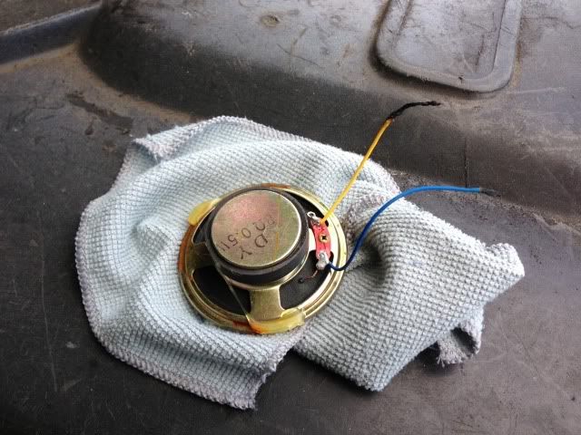

Found a speaker off an old radio this should do  :y

Tried 2 different types of speakers nothing happens  :-\

Got it to work just joining new speaker in the boot can hear it fine from there  :y

There is like a constant beep sound when in reverse but once you get close to an object they start beeping slowly getting faster as you get closer as they should just wondering is the constant beep if not moving and no objects in the way normal (when in reverse) or an error of some kind ?
I also believe one of the sensors aren't working middle left one but I'm happy that I've more a less fixed it :)
