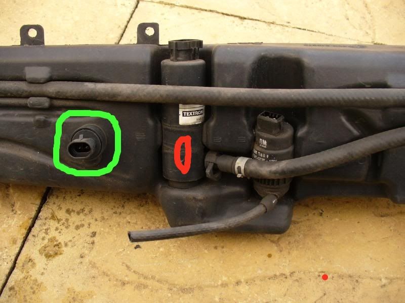

Headlamp washers not working. :(
Is there a known problem or anything in particular I should check first.

Assuming they were tested with lights on.
Green fuse in relay box by battery
If OK apply 12V to washer pump (red in pic)
If pump spins, remove it and clean filter

It,s the pump.
Ordered one off ebay £40. Seems a lot when the windscreen ones are under a tenner.
Mot tester says he's failed a fair few on this, as it's a relativley new test this year,
and most people are'nt aware of it, me included.
Also thanks for the pics RobG made finding the problem so much easier.

:o :o :o Should have asked me
If you want pictures ................ RobG is the man!  :y  :y  :y
