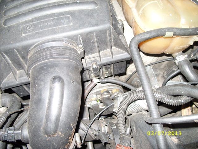

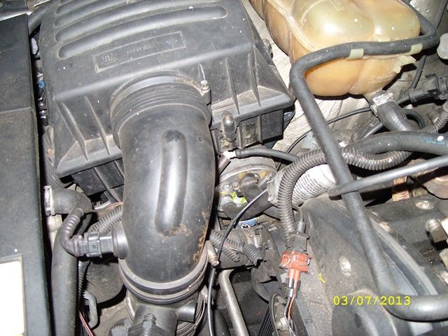

mine is behind airbox under expansion tank--easiest place for routing pipework :y :y can take piccie if wanted :y

« Reply #7 on: 03 July 2013, 21:15:08 »
does this help at all

Yes al, I've read them. Many times  ;D
I was just a little put out by the initial problem, and sought some inspiration!
And thanks symes, I'm going to go out and have a look  :y
Though that vap looks smaller or more compact than mine.

mate-i got 2.5--that unit good for 3.0--it's zavoli  :y
