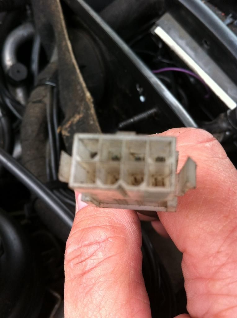

Tried again there but same result. When I got out of the car hearda  slight hissing from around the rear wheel. No smell of gas but did sound like a possible leak. Only for a short time so may be something else. Didn't seem like filler or tank, but under the car. there are no joins there though. Only one piece filler to tank pipe, and tank to vap. Again, one piece. May be unrelated.
Concerned about the ECU now. This is the plug
][URL=http://s877.photobucket.com/user/jonnyi2112/media/IMG_1349_zpsbcc63afb.jpg.html][/url]

Two pics??? D'oh!
