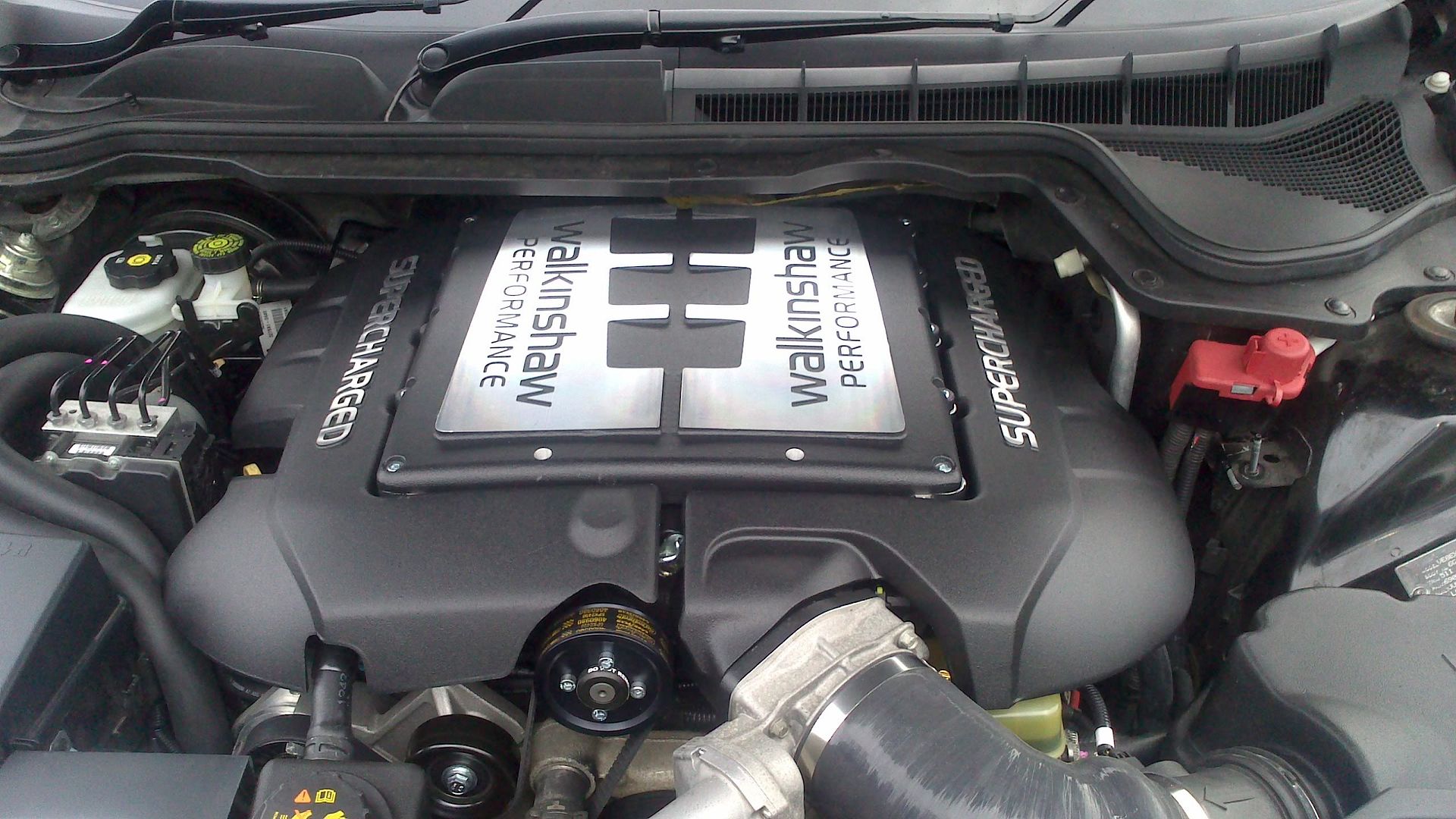

« Reply #202 on: 17 October 2013, 14:27:10 »
So
Twin scroll supercharger with twin water intercoolers.
Intercoolers are conneted to a water-air radiator mounted in the lower section of the front grill.
Amazingly, original engine internals used and no change to pistons etc to reduce the compression ratio!
It was leaning out at 580bhp so they dropped it just a little.
Next year it gets cam and bigger fuel pump apparantly.

So
They do that... second fuel pump sorts it :y
Bottom end good for 700+bhp... which is nice 8)
