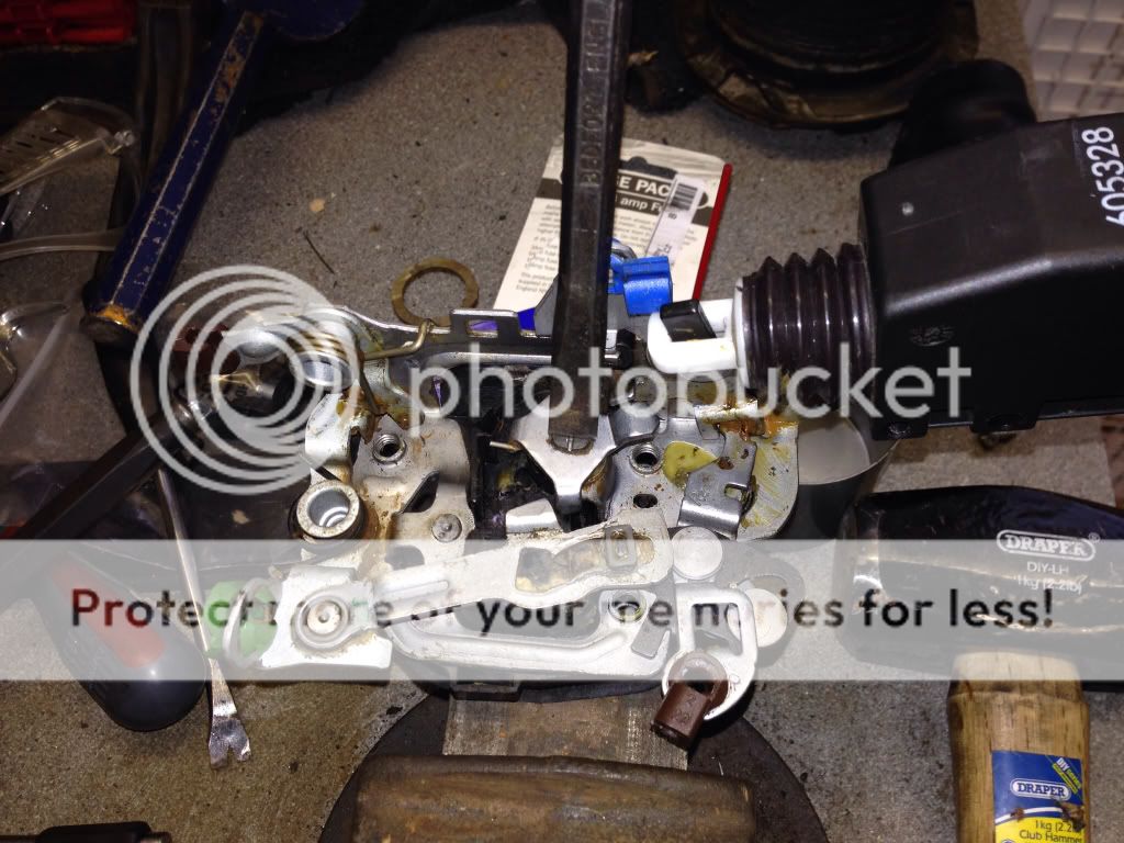

Had the motor and mechanism out today. Thought I had another motor, then realised a certain admin had it. ::)
But the mechanism had what seems to be quite a common fault, in that the central 4 prong plate was loose on its shaft. Big snack with a cold chisel and a hammer to tighten up the rivet on the shaft sorted the play, and i can now unlock the car via the door pin fro inside where I couldn't before.
Something is still not quite right, as the rest of the door pins occasionally don't lick with the drivers door. See how it goes for a day or two.
