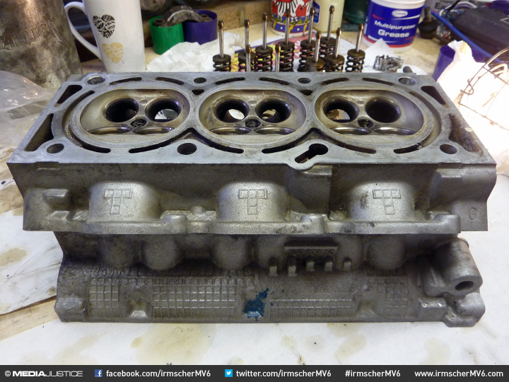

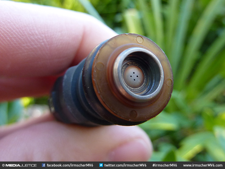

Talking of which, I’ve been sourcing plenty of new parts for the MV6’s Y32SE engine; both cylinder heads have been stripped, cleaned and rebuilt with new valve stem seals, and I enlisted the assistance of the guys at Injectortune when it came to refreshing the 3.2-litre lump’s Bosch fuel injectors.
Over time, dust particles and other contaminants can cause injectors to run below their full potential, and spray patterns can be vastly affected by loose matter floating around a car’s fuel system. Injectortune stripped, ultrasonically cleaned and rebuilt each of my injectors (complete with new filters and o-rings) before shipping them back to me with a ‘before and after’ report highlighting the improved static flow of each unit. Better still, a forward leak detected on injector number two has now been completely eradicated thanks to this excellent cleaning process, and I already know that smoother engine operation and quicker response is a given thanks to the exact same work carried out on the injectors of my V6-equipped Mk3 Cavalier CDX a few years ago. Nice!

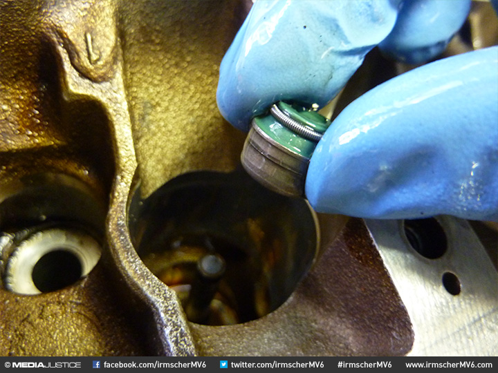

Old and new valve stem seals. Can you tell which is which?!  :p

Heads during the cleaning process:
Fitting the stem seals:
A small socket was used to push them into place:
Refurbished fuel injector spray nozzle(s):

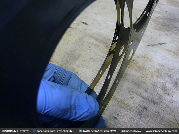

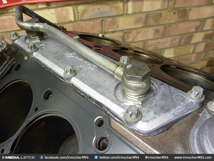

Triple layer metal head gasket(s):

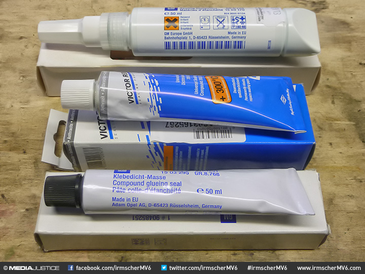

New genuine sealants:

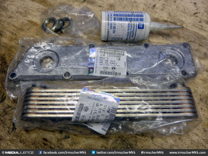

New oil cooler kit:
And fitted:

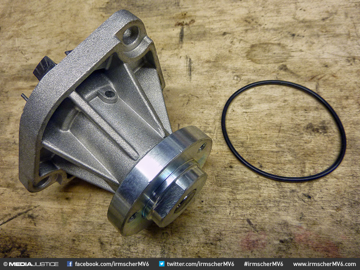

New water pump and seal:

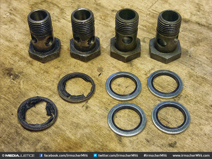

Cleaned coolant bridge bolts and new seals (right):

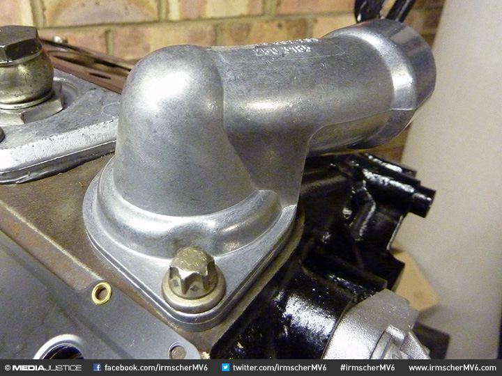

Courtenay Sport cool running thermostat in brand new genuine GM 'stat housing:

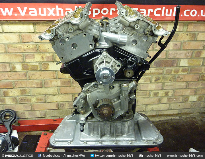

New genuine coolant pipe and sealing rings:
New head bolts:
Heads on:

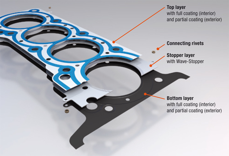

'Scooz me for being a bit fick here but ..... metal headgaskets....? Is there a reason as to why you are fitting these or is it that they are just 'better' than the other type...?
If theyre better than the other type and are a good upgrade..... any chance of a link as to where to purchase them from...?
BTW - why fit the cool running thermostat...? no need for fitting that in this country unless you are planning on taking it to warmer places regularly...?
All looking good BTW and I wish I had your contacts for parts....
Multi-layer steel head gaskets usually consist of two to five sheets of sandwiched spring or carbon steel. They are claimed to offer higher sealing potential than composite gaskets (which is why they are present on the majority of modern engines). For improved sealing of gasses and liquids, beads around the combustion chambers and oil/coolant passages increase the local sealing pressure (macro sealing), while full-surface or partial elastomer coatings provide additional sealing tightness (micro sealing).

3.2 left the factory with multi layer metal gaskets fitted, so hardly a new idea ::)
I was gonna say that  :P

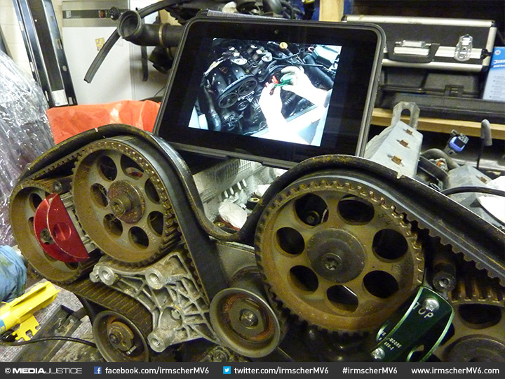

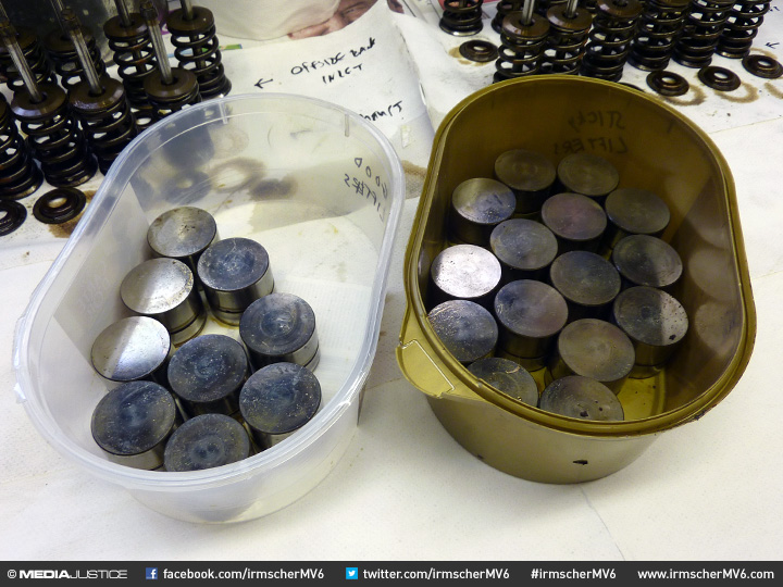

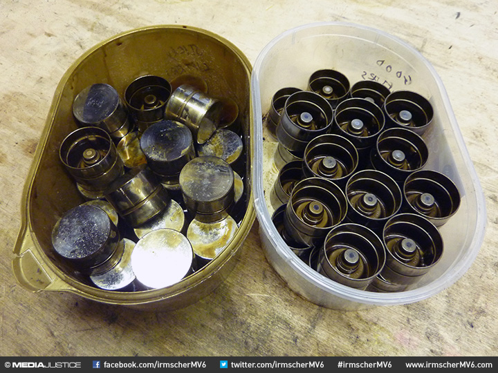

With one of my donor engines becoming the MV6's new powerplant, I decided to start stripping the car's original Y32SE. It kindly donated its 'G' cams and enough perfectly functioning hydraulic lifters to ensure that I had exactly 24 fully operational parts laid out in front of me. Lucky, huh?!
Let’s get stripping!
OOF cambelt video proved useful as a point of reference:

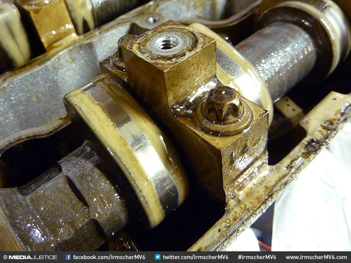

Ugh! That is one horrid milky mess!
Never mind. We all know what we’re here for!

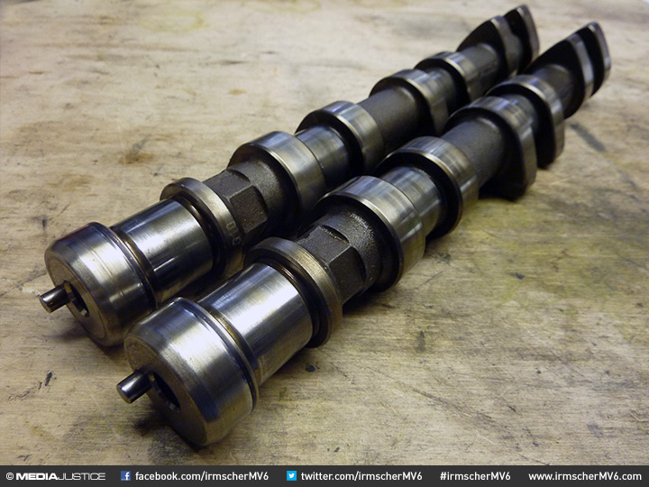

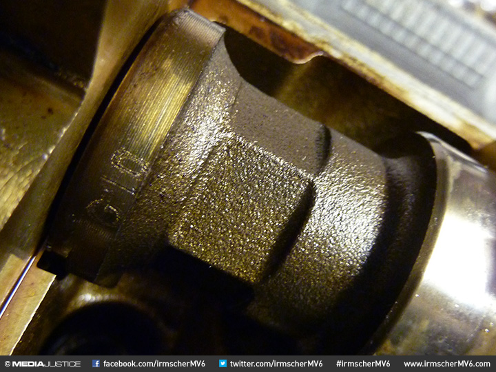

Both ‘G’ cams removed and cleaned:

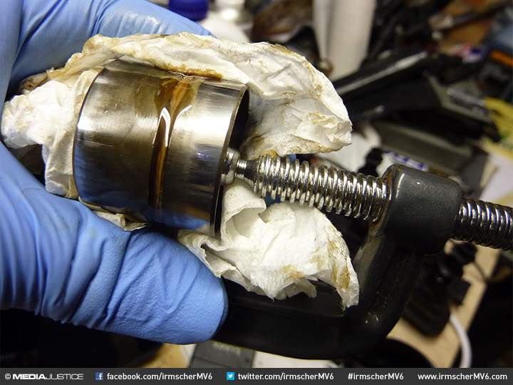

These are the lifters that were taken out of the car’s new engine. As you can see, I have put the working examples in the tub on the left. Clearly, there were more bad than good:
This is what I was left with after raiding the car’s original engine – 24 good and 24 ‘sticky’ lifters. A close call! At one point, it looked as though I was gonna have to raid another of my spare Y32SEs!

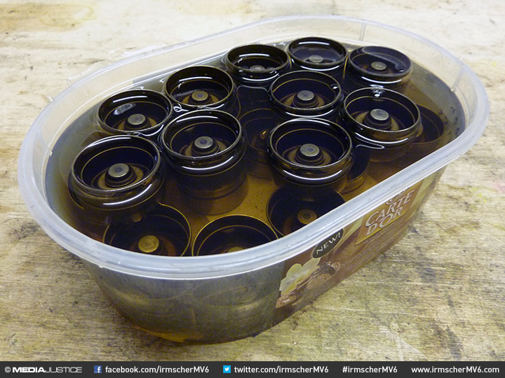

Squeezing the old oil and milky mank out of each of the good lifters. This took an absolute age:
With each lifter finally free of any obvious/readily removable contaminants, the parts were left to soak in petrol in an effort to break down any remaining deposits. I’ll prime each lifter with fresh oil before installation. Pics to follow.
