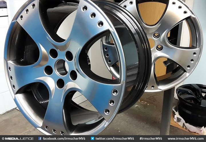

A sneak peek of what's been happening at The Wheel Genie. Yup, you're looking at my staggered Irmscher Sport Stars getting a lick of BMW E39 M5 Chrome Shadow paint following a comprehensive restoration procedure. More to follow :)

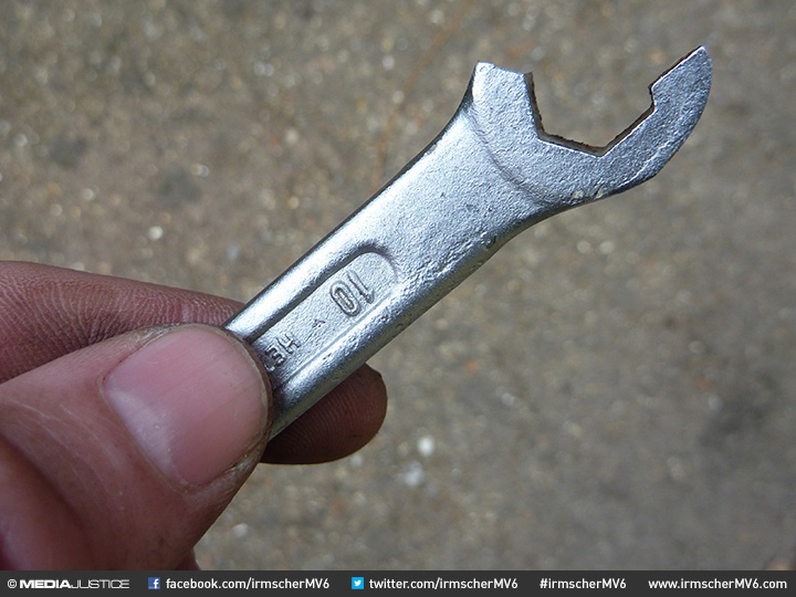

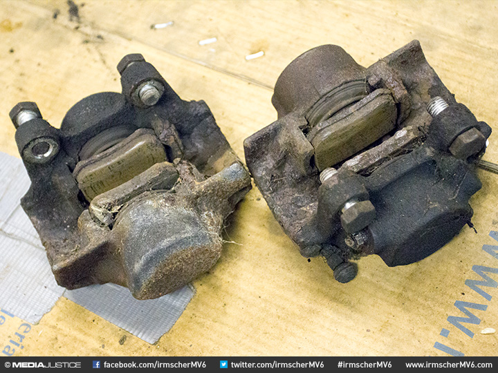

I decided to remove the car's rear brake calipers so that they can be stripped and powdercoated to match the six-pot Brembos at the front. The pipe nuts were having none of it and registered their disapproval by snapping my brake spanner. Sheesh. I ended up cutting the brake pipes to get the calipers off! I'll make some replacement pipes when the calipers are ready to go back on.
What a mess!

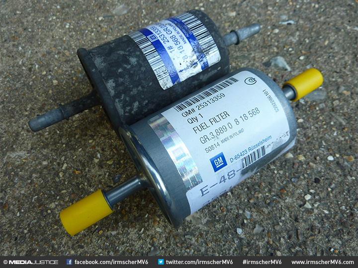

I added a new genuine fuel filter while I was digging around at the back of the car. And why not, eh?!

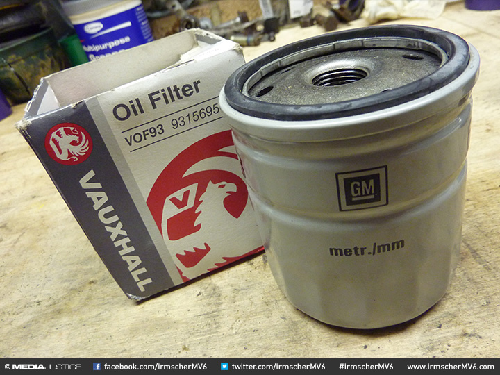

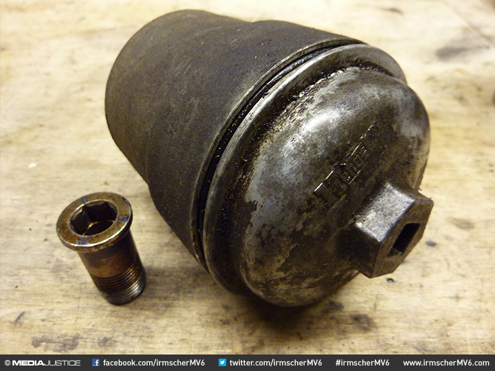

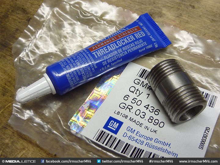

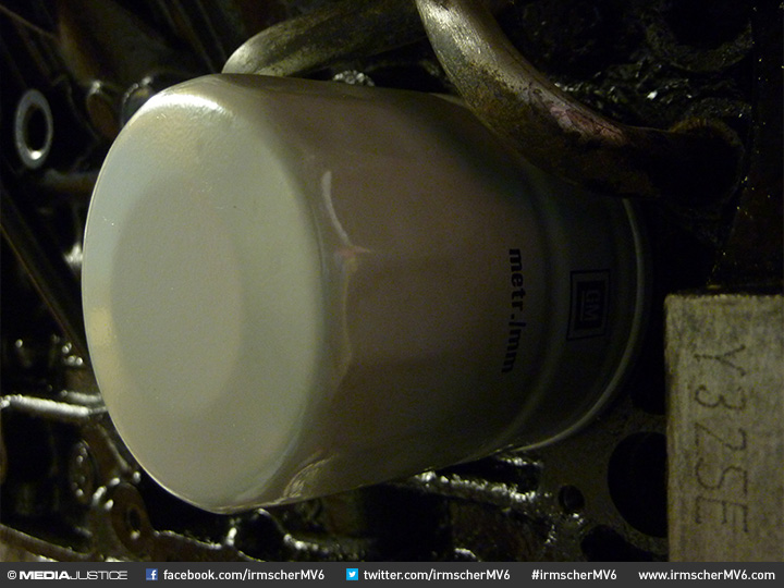

I've got loads of genuine GM screw-on oil filters in my arsenal of service parts due to the fact that I've owned a succession of Cavalier Turbos. It made sense to ditch the MV6's permacanister and convert the filter type to that of the Cavaliers.
Canister removed:

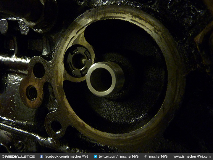

Spin-on connector and permanent threadlock:
Fitted:

Wow that must of been one hell of a seized bolt lol  ;D
