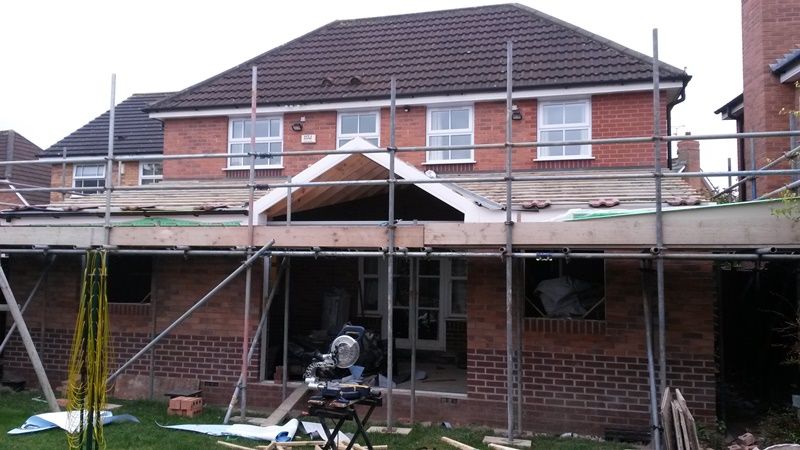

Two solid days finishing off the roof timbers, all now secured, trimmed, straightened (with noggins top and bottom) and the wall plate anchored.
Scaffolding up today.
Two steel box section to fab during the week for above the bi-fold.
Bricklayers coming on Saturday morning to fill the gables in and then its on with the roof.  :y

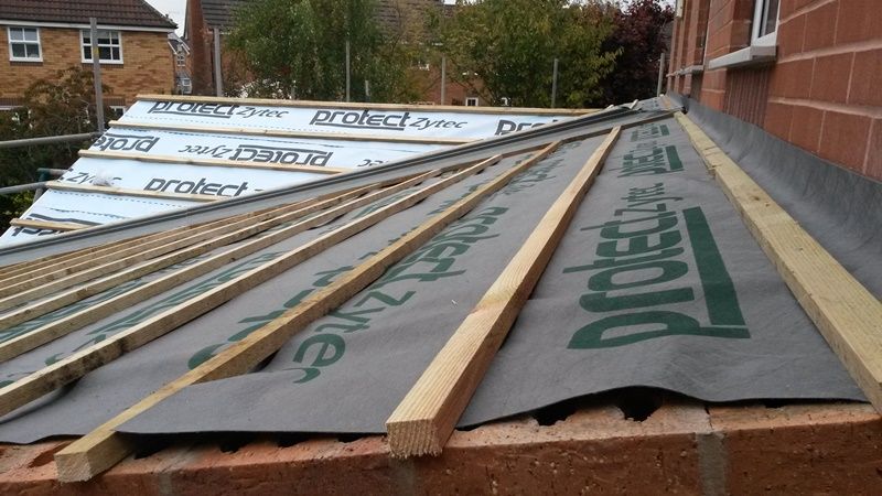

Another busy weekend, in fact a few
So the brick layers have completed the gable ends and I fabricated a steel beam for above the Bi-folds opening to stop roof spread of the gable end.
Then this weekend it was on with the facia, felt and laths:
Tiles arrive on Wednesday but, this weekends work means we are now water tight.  :y
Velux fitting next job once my roofer friend has marked out his tile runs.

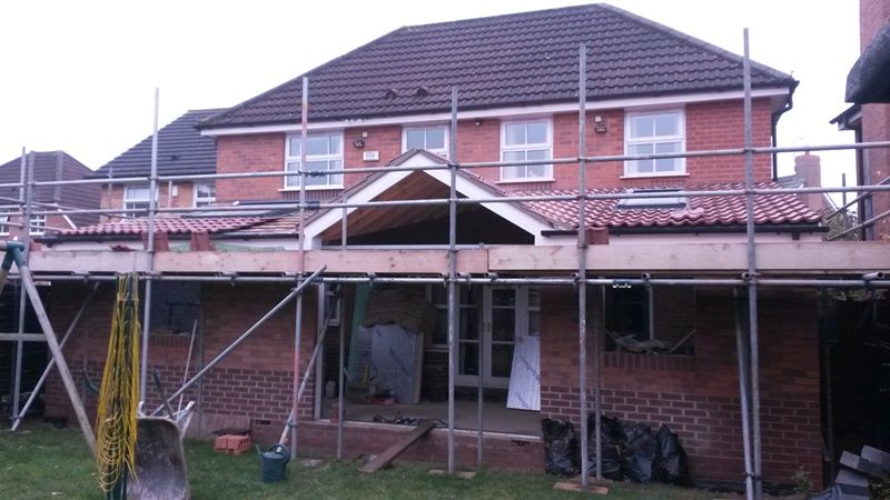

Further positive moves towards sealing the extension over the last week.
Both Velux windows have been fitted (bought from Holland as its much cheaper there than here!) including insulation collar, felt collar and flashing kit (those window sections are chuffing heavy !)
Tile fitting has started with one side gable complete and pointed, three valley cuts made, two valley cuts pointed, rear gable tiled and pointed and one velux cut in.
