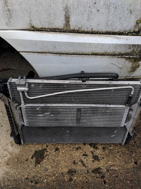

  • Posts: 37649
Re: Coolant leak
« Reply #12 on: 07 August 2019, 09:44:18 »
So Serek found HBV was leaking and replaced that (2 year old genuine) - But still have a coolant leak.  :(
Lost a 3rd of the header tank on a ~50 mile run, not used it today will get it on ramps tomorrow.
Had a quick look yesterday, HBV area all dry and underneath the car/tarmac was all dry and it was parked in a multi-story. I would have expected to find a puddle at some point.  :-\
