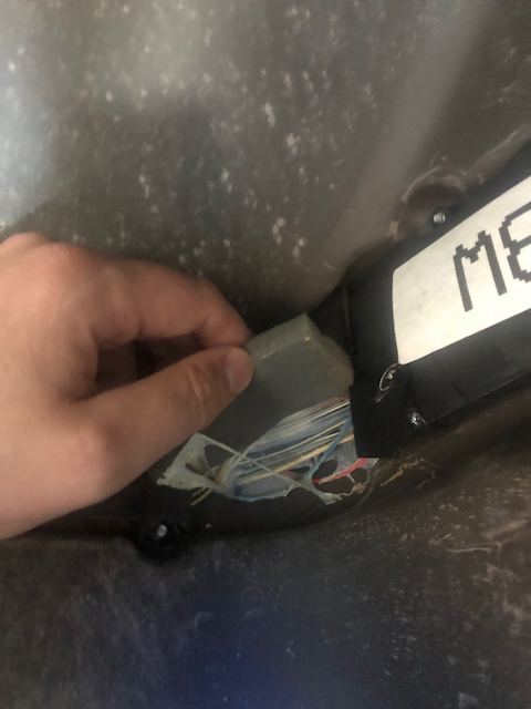

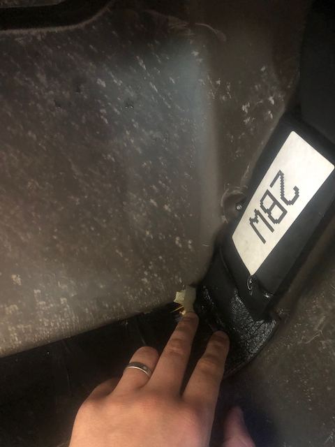

New cap inconclusive, initially I thought the problem had resolved, it appears to have lost less over 60 mile return trip to work. But I think it has dropped a bit, will know more after tomorrows work run.
However I pulled up carpet in passenger footwell, it appears damp and I can see traces of water. Can't tell if it's coolant, also the sponge area around this wiring loom also feeds damp.  :-\
Scuttle area clean and dry, never had any issues as it never gets clogged around here.
