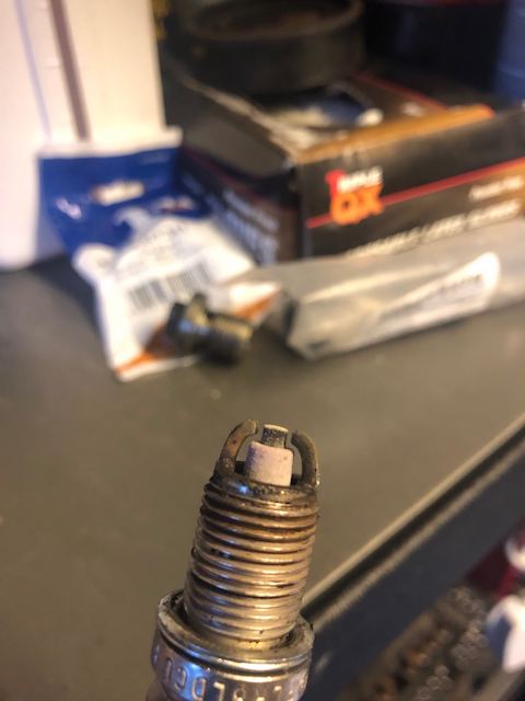

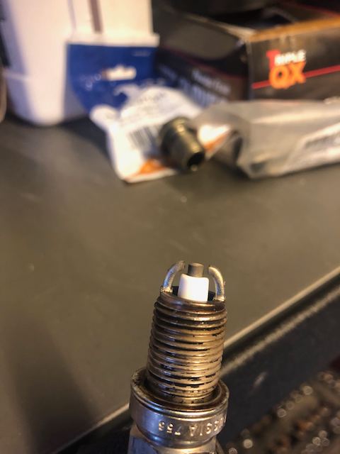

I took the plugs out today, on drivers bank. As cylinder 5 gave me miss-fire before. Bear in mind these plugs have done less than 1,000 miles....
Pot One, looking nice and clean: (as did pot3)
Pot Five However
It was slightly cleaner on one side.
Is that a hint of red I see?  :-\ (i put red food colour dye in system)
« Last Edit: 10 September 2019, 20:48:53 by tunnie »

Number five looks unwashed...
