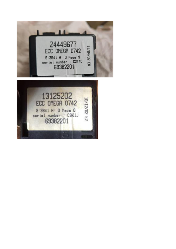

Found several spares but still two questions:
1. Which numbers are important here? Upper one is mine, 69382201 is same in both others not. Does this matter?
2. Do I need programming/Tech2 etc. if changed?
  • Posts: 30705
Re: 12V Pumps in Cooling System
« Reply #41 on: 30 October 2022, 09:38:45 »
Lower one is newer. But they are interchangeable  ;)
