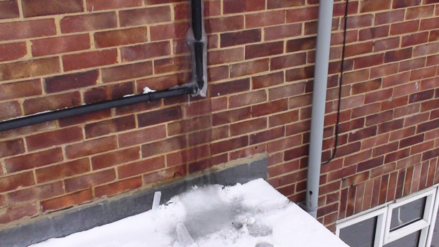

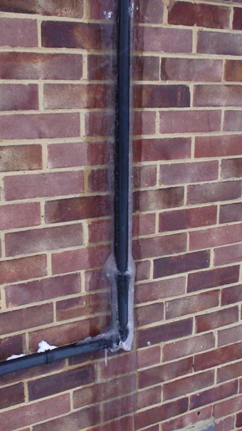

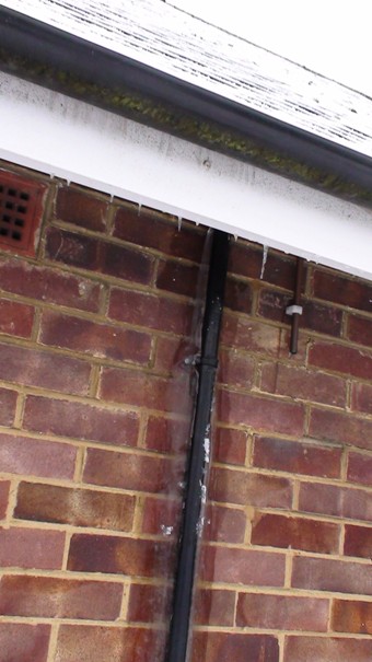

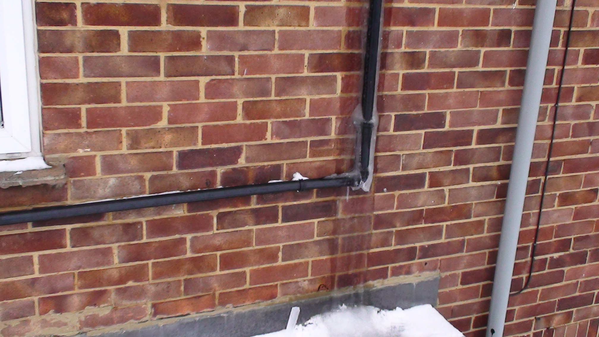

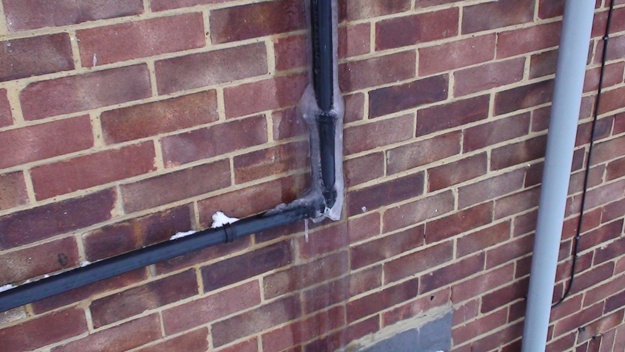

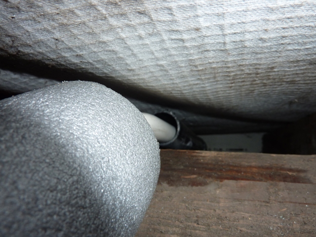

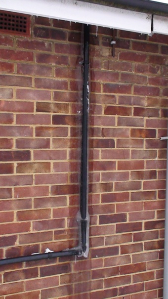

TB Asked me to post these - This is a British Gas install at a colleagues house

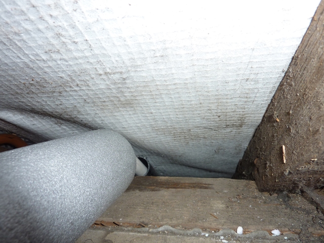

As can be seen from the photos Jimbob posted for me earlier, the idiots haven't put any fall on the pipe, its frozen at the elbow, then overflowed into the loft space (fortunately, most of the water ran outside the house. The photos do not do it justice, the vertical part of the pipe is frozen solid, as is all the water that overflowed at the top.
Bloody cowboys
