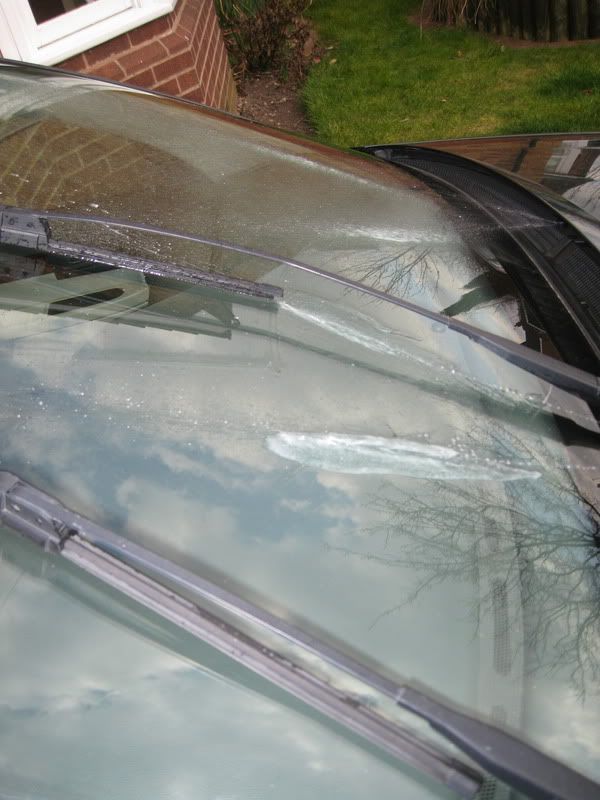

Just fited one of these to the passenger side of my facelift omega to see how good they are.
They fit easily enough and once the nozzle is adjusted (it needs angling up a lot) they appear to aim well.
So, after a trial of a few weeks I will see how good they are and then fit the drivers side one.
Pros:
Uses a fan wash pattern so gives mush better screen coverage when washing.....which reduces screen wash consumption
Cons:
No heater element, not a big issues on the facelift given where the jets are located but, looks like one could be fitted for a few pence.
And the cost....about 3-4 quid.

Mark...Could we have a little further information please, perhaps a piccy or two. Sounds a good idea, something different. !
Give me an hour...

Heres a pic

« Reply #12 on: 16 March 2010, 14:19:09 »
Thank you Mark.  So you just push/slot them over the spouts that are already there ???
  • Posts: 34170
Re: Insignia washer jets
« Reply #13 on: 16 March 2010, 14:20:37 »
No, push the old jets out through the scuttle....pull the pipes off (the hardest bit), push the pipes onto the new jets and insert back through the scuttle.
Then adjust the aim (although I adjusted mine up quite a bit before fitting as its easier to get at)
