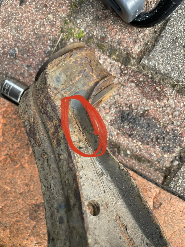

Today I replaced the front wishbones, glad I did!

First time I have ever seen one crack there :o
What did it look like on the other side of the wishbone?

Looks like rust to me.

Rusted from the seam where the two parts are spot welded together. Probably because that area is the one most likely to flex.
One of many reasons I don't bother with the strip/clean/paint/polish knackered GM wishbones routine.

So corroded out from between the halves and fractured along a stress line from the original pressing?
As opposed to a fatigue failure as you might find on the rear bush or ball joint mounting that are weakest in the direction of suspension movement...

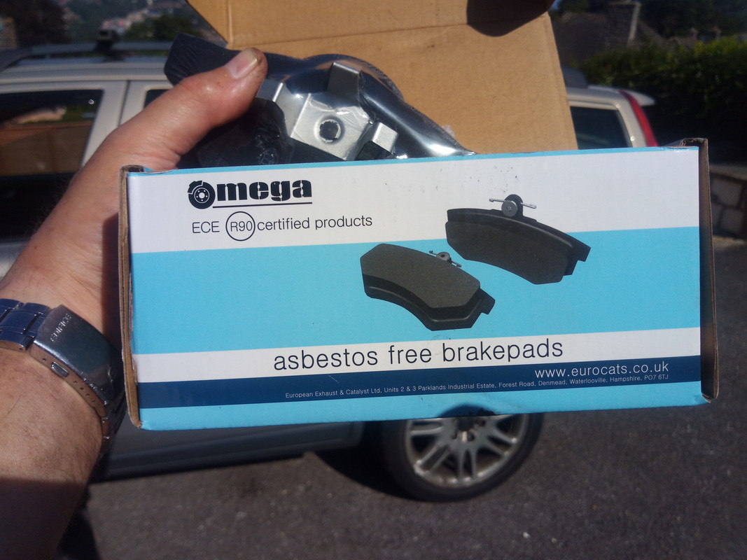

First car work for ages! Fitted new front pads on the V70.  :y
Omega brand! What can possibly go wrong?  ;D
