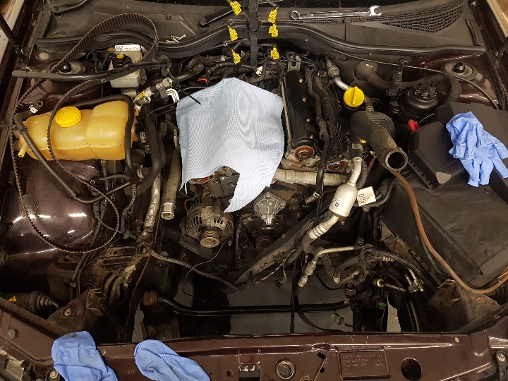

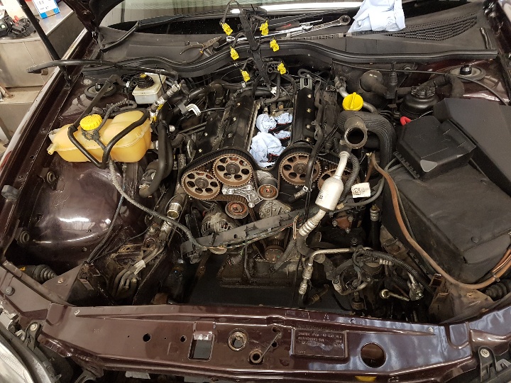

Cam belt change, is also the right time to investigate oil leaks, which are expected to be from the cam covers.
Once cam wheels were removed it was obvious that the leaks were mainly from the front cam seals.
well done for looking properly, finding the problems and not just rushing through it  :y
