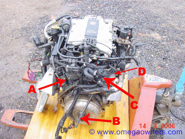

Its related to the rear multiram solenoid which is mounted on the rear of the plenum.....has the plenum been removed recently??

  • Posts: 34112
Re: Fault code help need please
« Reply #5 on: 06 November 2007, 11:23:07 »
Right
Well check the back right hand corner of teh plenum, you should see a small solenoid with a 2 pn connector and some vac hoses on it.
Make sure its plugged in and there is no damage to it.
If you look at the following picture which is a shot of the rear of the engine, you will see the item bolted to the back of the plenum...
I wonder if it was damaged/disconnected whilst the crank sensor was being changed.
