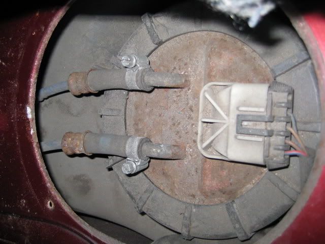

What state are the fuel lines that connect to the the tank in (under the metal plate in the boot)
  • Posts: 24558
Re: Shuddering & Petrol Smell
« Reply #12 on: 16 March 2009, 13:57:37 »
I'll just go and check.....

  • Posts: 24558
« Reply #14 on: 16 March 2009, 14:11:31 »
fuel pipes :
