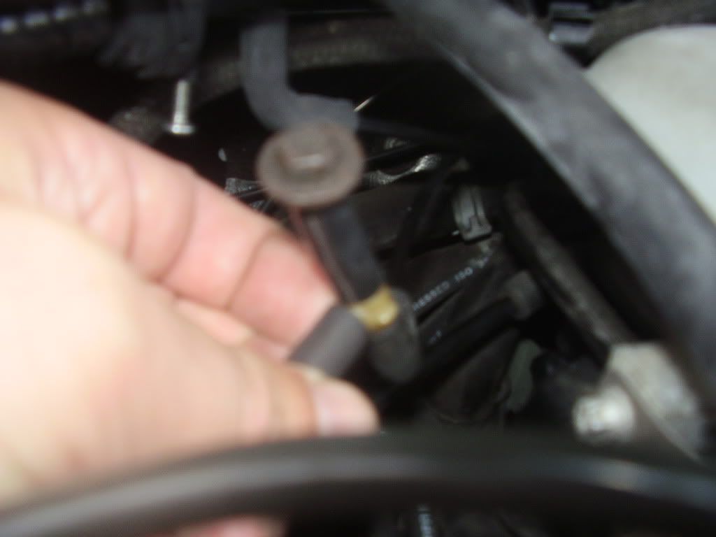

Just found this, whilst poking about at the rear of the plennum. A rusty screw stuck in arubber pipe, any ideas folks?
Keep Calm And Carry On.......
Re: Still Stalling......
« Reply #7 on: 08 July 2009, 21:57:25 »
yes that pipe should fit into a rubber elbow a beleive. Looks like its hanging down in the back ground of the pic. Or one very like it anyway. But that screw is wrong, whatever.

« Reply #8 on: 08 July 2009, 22:02:29 »
Yep thats certainly wrong lol Looks like vac pipe...either the one thats meant to go into the back of the plenum (rear multiram??) or that fits into the brake servo pipe??

The couple of "T" pieces by the brake servo were as they should be. Checked them when we Tech 2'd it. Multirams were working OK after we'd corrected incorrect plumbing of the vacuum reservoir.
Whereabouts is that T piece? can you follow the pipes to see where they go? Maybe it's the heater vacuum supply. Is the claimate behaving itself?

Thanks Kevin, I'll have a look later. Just tried climate, I don't use it very often, and it blows cold until I put it on High setting - it then blows hot??  :-? I think I will go and find a large skip!!  >:( >:(
